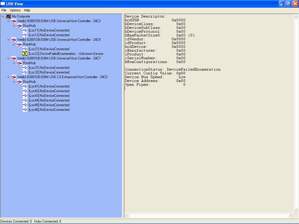

Postby west_minist » Wed Oct 12, 2005 6:42 pm
Hi Colby!
Have you been able to look @ my old cable that I sent you?
Have you found out why it stopped working?
The new cable you sent me only work for 2-3 days and since then, would not come as usb <> serial.
I plan to try it tomorrow with some other laptops, beside my desktop and laptop.
I normal keep the cable in the car.
I believe so far that I am the only one getting this problem.
Could my ECU be damaging the device?????
