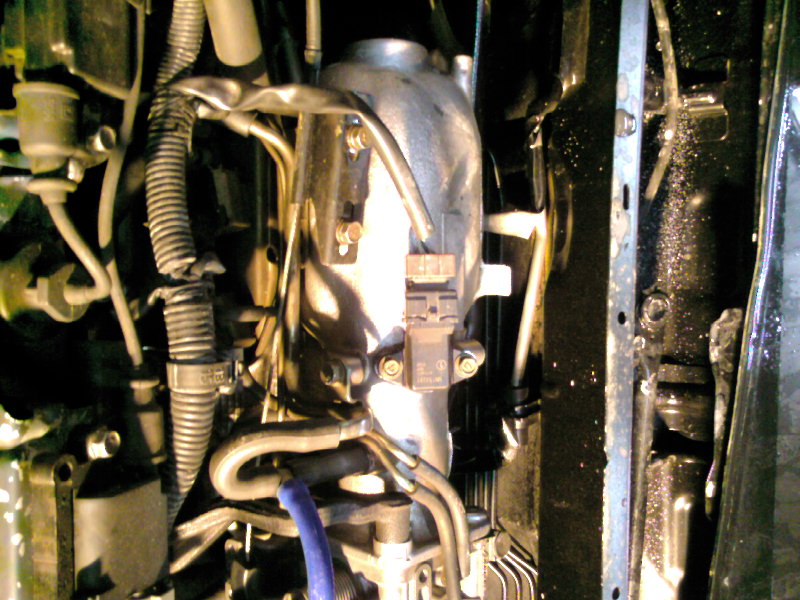

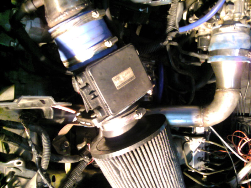

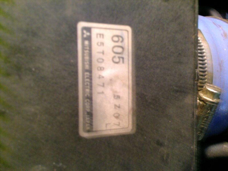

Thanks a Mil Amacus, I can read the fuel and Ignition maps with this xml, I'm getting some pics of the motor which I'll post shortly. This cars got a MAF sensor for sure and a 3 wire sensor which looks like Map sensor installed on the manifold. I'm trying to do a tune on a turbo build of a friend of mine who's unhappy with the current piggy back he's got

Postby Zakie@TIC » Sat Aug 16, 2008 6:58 am
Here are the pics of the 2004 Asian Cedia motor, its 2.0 lt NA with a after market turbo installed.
