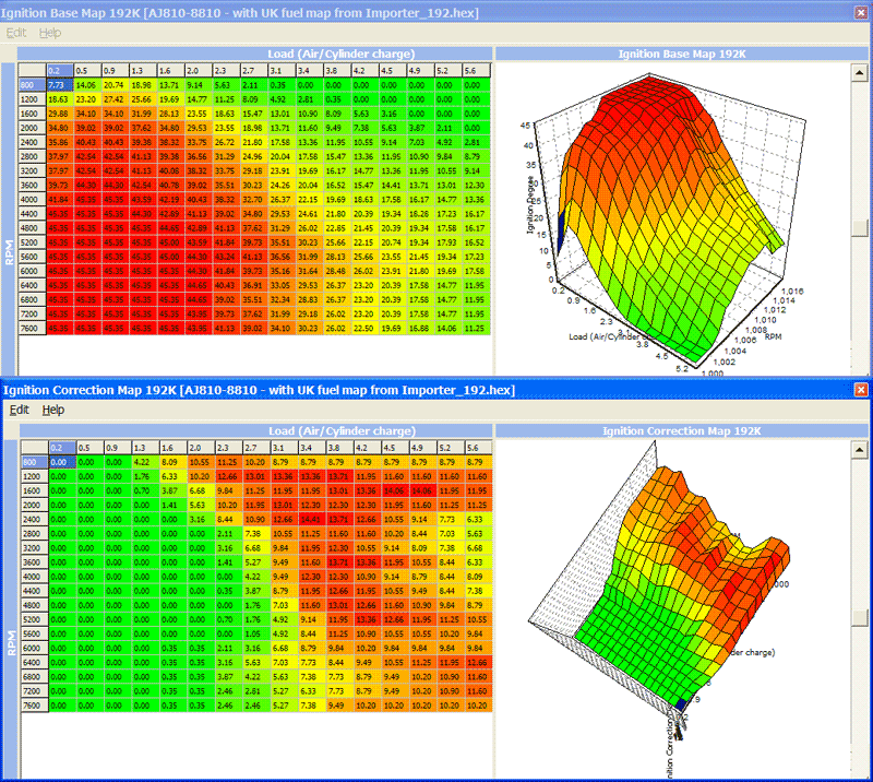

Postby crispyduck » Tue Jan 24, 2006 1:10 pm
Zak,
Ok, here goes for the Ignition and Timing Correction Maps. Attached is a ECUEdit screen shot and also the XML configuration file for all we have so far.
Let us know if you need more help.
ecuEdit_dot_xml.txt
Replace your ecuEdit.xml file with this.
(3.5 KiB) Downloaded 813 times

Postby crispyduck » Thu Jan 26, 2006 12:56 am
Mo wrote:Thankyou Steve and Freon, you've been a great help. I could locate what looked like tables but then it wasn't consistent, I'd get both the skewed and chequer board effect and didn't know why but with your explainations I should be able to move on. I went out this afternoon and took some runs and was hitting 6.41 on the load scale so some re-scaling is in order!
I'll keep you all updated with my progress.
Glad we could help. Looks like the first three columns in your map could be put to better use ;-)

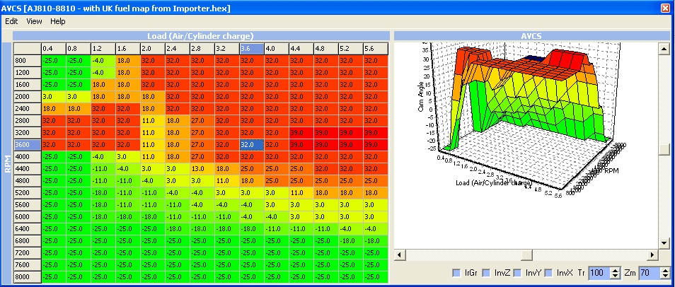

Postby west_minist » Tue Apr 04, 2006 11:40 pm
XML attached.
MY05 Impreza JDM STi AJ810-8801 A4TJ111B - Maps.xml
(3.09 KiB) Downloaded 792 times
MY05 Impreza JDM STi AJ810-8801 A4TJ111B - AVCS Map.jpg (307.34 KiB) Viewed 8468 times
