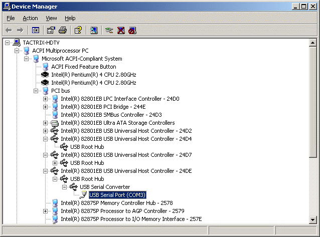

Postby cboles » Sat Jul 09, 2005 9:22 pm
Can you be more specific about the problem you have with the driver installation? Does the driver install correctly, but the device does not work, or is it a different problem? Run devmgmt.msc and choose View | Devices by connection, then traverse the device tree out to your USB Hub where the OpenPort is located (see attached image). Does it look like this, or are there missing / disabled device nodes?
