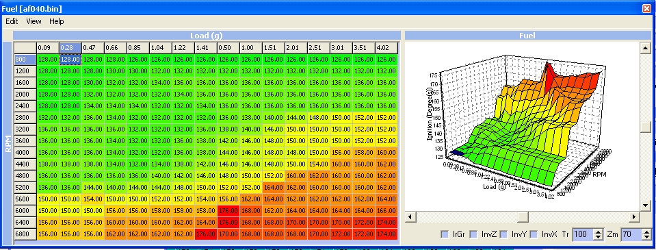

Postby west_minist » Wed Apr 12, 2006 4:55 pm
Can anyone tell mewhat these numbers look like?
Postby Hitokiri » Wed Apr 12, 2006 9:12 pm
STI6!!!!! YESSSSSS!!!!
west - thats the fuel map
try scaling the data values with the following
14.7/(1 + (([value]-128))/128))
Postby Hitokiri » Wed Apr 12, 2006 11:02 pm
It is very interesting to note, looking at these maps that the P1 ecu shown seems to have the same main maps as the JDM 040 ecu.............
I was under the impression that prodrive had a special tune on their car, but it seems they just slapped the slightly more powerful JDM maps in there and called it a day.. verrrry interesting.
Postby Hitokiri » Wed Apr 12, 2006 11:22 pm
Interestingly enough these ecus all seem to use the same structure for storing major maps
here is the xml I have been using lately:
The load is still wrong - but otherwise most conversion seem ok. Its good for compairing fuel - timing - boost - wg tables though :)

Postby STi6 » Thu Apr 13, 2006 12:24 am
They will all have the same structure. It will just be interesting to see how the maps differ, say from a AE802 (WRX) to a (JDM STi) AF001
