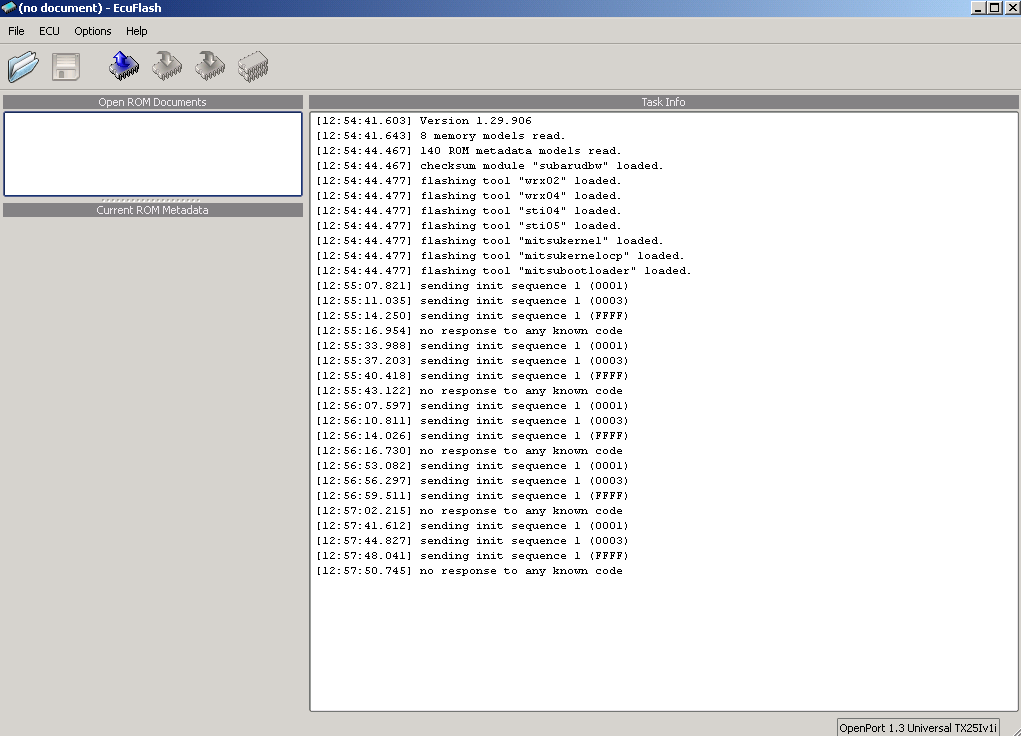

Postby bigleadfoot » Sun Nov 26, 2006 3:28 am
Hy!
May I join in here as I have a little problem reading the rom of my IXer.
I connected the cable (the OBD plug and the white one), switched on the ignition and started ecuflash. When I try to read the rom, the dialog for selecting the car pops up and when I select "2006 Evo 9" and hit "Read" I get the following result (see attached picture). I've tried a couple of different approaches, but nothing really works.
What I tried without success:
- Started ecuflash, hit read rom, connected the obd and white plug, ignitoon on and then hit "Ok".
- Cable connected to car (both plugs), ignition on, started ecuflash, hit read rom and then hit "Ok".
- Cable connected to car (both plugs), started ecuflash, hit read rom, ignition on and then hit "Ok".
Then I ran out of ideas.
When I start up evoscan 0.97 it works perfect, just ecuflash refuses the cooperation.
Car is a 2006 EVO 9 German model.
Any help would be appreciated.
Thanks.
Alex

Postby S54fan » Sat Dec 09, 2006 3:08 pm
If this is a UK IX then it has been Ecutek'd and you need to use aktivematrix.com ECU unlocker.
If not a UK car I don't know why you are experiencing this problem.
Postby bigleadfoot » Sun Dec 10, 2006 1:33 am
Hy!
Thanks for the help. But as I wrote the car is a 2006 EVO 9 German model. No UK import or something and it has not been ecutek'd either (as far as I know). I got it with 45 km/27 mls on the odometer). I will try the ecu unlocker and see if this works.
Thanks.
Edit: Tried with ecu unlocker
[17:00:24.172] Version 1.29.906
[17:00:24.212] 8 memory models read.
[17:00:27.266] 140 ROM metadata models read.
[17:00:27.266] checksum module "subarudbw" loaded.
[17:00:27.266] flashing tool "wrx02" loaded.
[17:00:27.266] flashing tool "wrx04" loaded.
[17:00:27.266] flashing tool "sti04" loaded.
[17:00:27.266] flashing tool "sti05" loaded.
[17:00:27.266] flashing tool "mitsukernel" loaded.
[17:00:27.266] flashing tool "mitsukernelocp" loaded.
[17:00:27.266] flashing tool "mitsubootloader" loaded.
[17:00:46.484] sending init sequence 1 (0001)
[17:00:49.749] sending init sequence 1 (0003)
[17:00:53.013] sending init sequence 1 (FFFF)
[17:00:56.268] sending init sequence 1 (F0F0)
[17:00:58.992] no response to any known code
[17:01:15.926] sending init sequence 1 (0001)
[17:01:19.171] sending init sequence 1 (0003)
[17:01:22.436] sending init sequence 1 (FFFF)
[17:01:25.680] sending init sequence 1 (F0F0)
[17:01:28.424] no response to any known code
[17:02:00.570] sending init sequence 1 (0001)
[17:02:03.825] sending init sequence 1 (0003)
[17:02:07.080] sending init sequence 1 (FFFF)
[17:02:10.334] sending init sequence 1 (F0F0)
[17:02:13.068] no response to any known code
