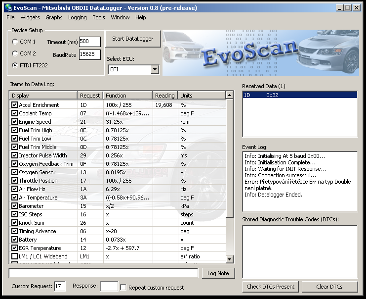

I has paid for the Evoscan but cant log my ECU. It is EVO IX GSR EDM, EcuFlash OK, but EvoScan ends loging after one value. I am using Czech Windows XP.
Please can you help me?

Im not positive, but I think I read somewhere it only works with the English version of XP right now.
krafty
Joined: Mon Aug 14, 2006 7:31 am
Postby Evo4Mad » Wed Aug 30, 2006 9:29 pm
yeah I wonder if it is just the interpretation of your funky character set.
Go into the DataSettings\data.xml file and set the evals to Eval="x" and you can manually calculate the values later on from the csv file. If it continues to pose a problem for you I have a copy of the czech windows xp and will get it working on my copy for you.

Evo4Mad > I am also from Czech but I am using English XP and I got same problem on EVO 8
Info: Initialising At 5 baud 0x00...
Info: Initialisation Complete...
Info: Waiting for INIT Response...
Info: Connection successful...
Error: Cast from string "Err" to type 'Double' is not valid.
Info: Datalogger Ended.
and I am not alone, another guy I think it was AutoXer have same experience :-(

Yes this "Error: Cast from string "Err" to type 'Double' is not valid." will be the same error like mines, only translated to czech

"Err" is only for the wideband items, UNTICK the wideband items, they dont work in v0.8

I had it off but still get the trouble.

I got this error once by using a DATA.XML file that had a typo in it. I have also gotten it when using a calculation such as: "2*x*0.234567". For some reason Evoscan did not agree with that syntax. Check the file to make sure that it is correct, or download a known good file.

Change your regionals setting an put '.' as séparator decimal and not comma (,).
This is your problem
