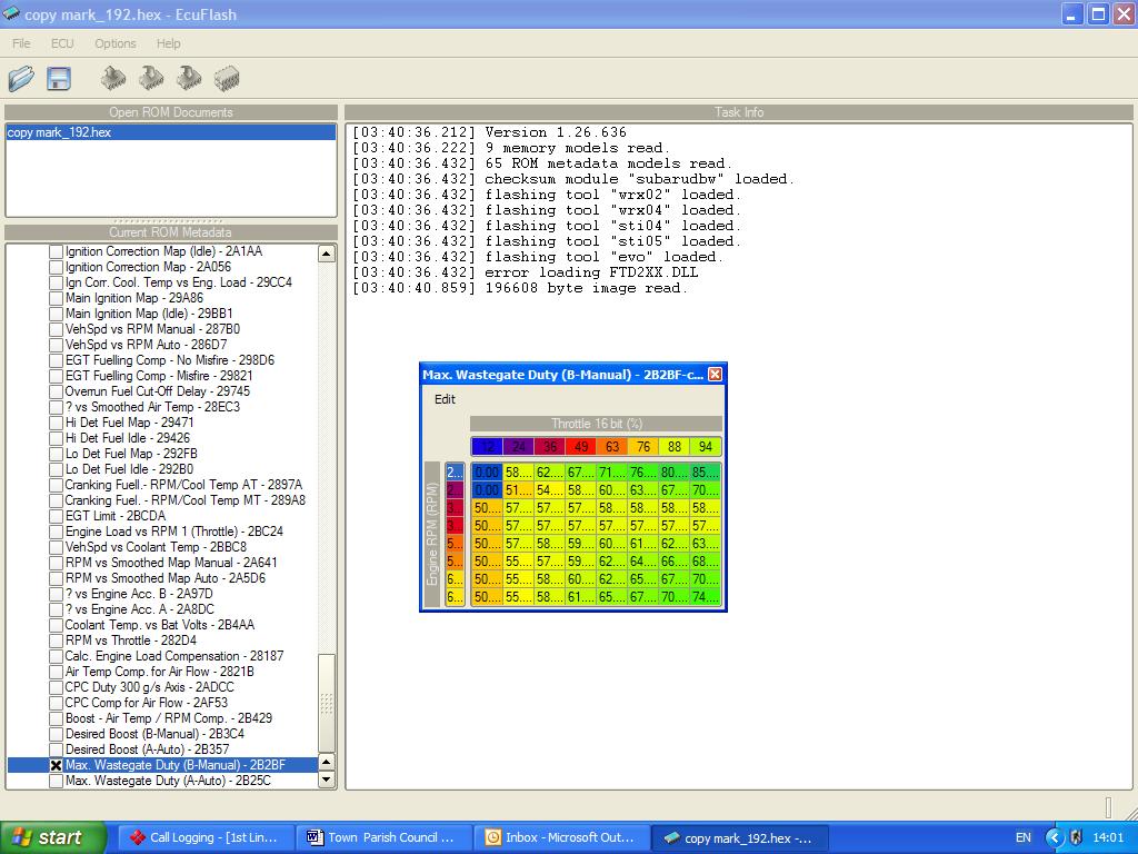

Resize windows
Postby New2Scoobs » Mon May 15, 2006 5:08 am
I cant resize map windows in ECUFLASH. Am I missing a DLL or something?
Tried uninstalling and then reinstalling but still cant resize.
Re: Resize windows
Postby cboles » Mon May 15, 2006 7:02 am
This problem is coming from XMLWRITE, or whomever made the definition for the map you are looking at. There is a min and max value for the scalings you are using, and EcuFlash looks at those values to decide how big the text can possibly be, and sizes the cells accordingly. If you have unrealistic min/max values, you will get this problem. You can change them by editing the scaling in the map definition.
