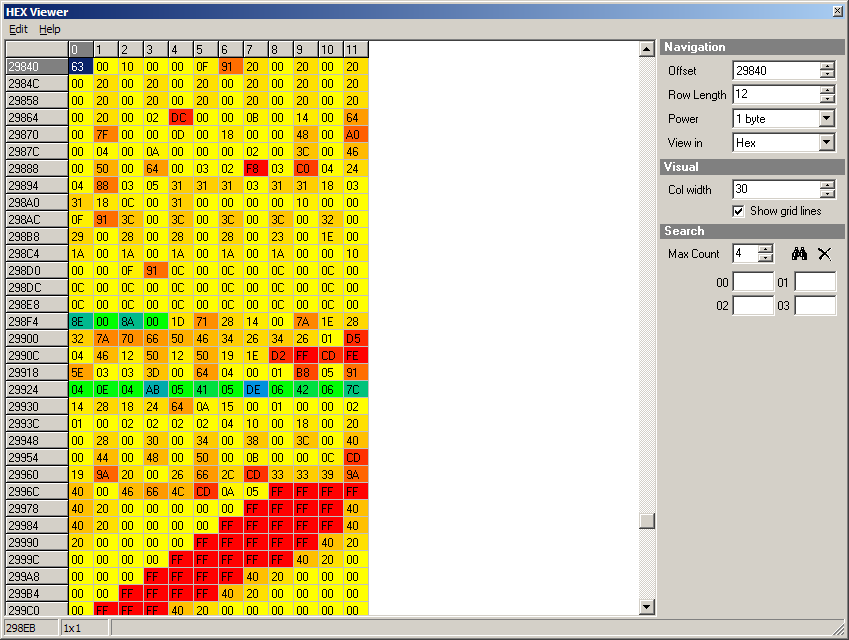

I'm using ecuEdit, but I've resorted to doing hex editing to actually make the changes in maps like this... ecuEdit has some endianness problems that I can't seem to sort out.
However, in the stock A4SG900C map, I've found the data at 0x29924-0x2992F... there's a total of six two-byte entries. There's no obvious axis data anywhere in the vicinity.

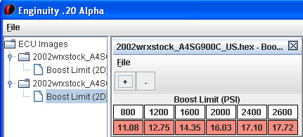

Attached is a screenshot of the presumed stock boost CEL map.

Postby qoncept » Wed Feb 08, 2006 4:04 pm
I could be way off here, but it looks like RPM right after the boost values -- the only descrepancy is the number of them (edit: and the gap between those values and the table values). The values at the right side of this table look reasonable, but they don't account for the extra RPM values I (think) I see in the image, and the left side is... possible.
You can put this in the Enginuity demo xml file and play around if you want to check it out.
   <rom>
      <romid>
         <xmlid>A4SG900C</xmlid>
         <internalidaddress>200</internalidaddress>
         <internalidstring>A4SG900C</internalidstring>
      </romid>
      <table type="2D" name="Boost Limit" storagetype="uint16" endian="little" storageaddress="0x29924" sizey="6">
         <scaling expression="x/93.7" format="#.00" increment="1" units="PSI" />
         <table type="Y Axis" name="Engine RPM" storagetype="uint16" endian="little" sizey="6" storageaddress="0x29943">
            <scaling units="RPM" expression="x/256*50" format="#" />
         </table>
      </table>
   </rom>
Postby qoncept » Wed Feb 08, 2006 4:31 pm
I'm going to go ahead and assume what I just posted was wrong.. but it just occured to me that the ECU doesn't store relative pressure, at least in other tables, it stores absolute pressure.. So while those numbers look pretty reasonable, there's a good chance we're missing something. It also stores boost as 1 byte elsewhere instead of 2.
Postby Kha0S » Wed Feb 08, 2006 6:01 pm
Yeah, those RPM values actually belong to the first of the two "mystery maps" that I've posted about in a thread elsewhere on these forums.
I increased the values in both of those maps by an additional 0x60 (for a total increase of 0xC7), and didn't suffer any boost cut tonight. I need to tweak my wastegate duties, but it seems that those are, indeed, the correct maps... still doesn't give me anything for the axis. :D
