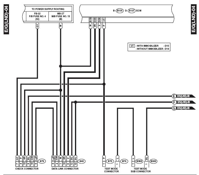

Postby Mad Max » Tue Jan 15, 2008 1:05 am
I found that K-line myst be in Pin 10 of OBD conector.
(See attached picture. This is schematic of Legacy 2004.)
I have it in my connector.
Ground (12,13) and +12 (1) they are present to.
But what is the pink wire on pin 6? is it L-line? In my connector pink wire is at pin 3.
By the way: how this F*king SSM protocol is work for data logging?
Is it one way connection or is it two way connection?

Postby radsdau » Tue Jan 15, 2008 6:50 pm
Mad Max wrote:By the way: how this F*king SSM protocol is work for data logging?
Only KLine is required for SSM protocol.
