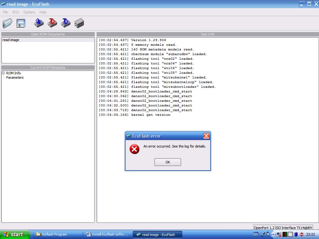

After following everystep and I got this error occurred message when reading the ECU. Please help what should I do to fix it? Thanks

Postby bolster » Thu Nov 09, 2006 5:38 pm
I'm getting the same error with mine.

Postby wrx-blue-mica » Thu Nov 09, 2006 9:30 pm
OK .. I forgot to connect the jumper flash socket. When I connect that flash jumper + green connector everything works now.

Postby Freon » Thu Nov 09, 2006 9:37 pm
Year? Model? Market? What cable? Exactly what steps did you take? What is the ECU id number? What powertrain?
Not too many people from Indonesia around here, so you'll need to fill us in.

Postby Freon » Sat Nov 11, 2006 2:36 am
Yes, same Freon.
Well that ECU should be supported. Ecuflash has XML for it. Do your fans start to cycle when you try? Did you get the green test connector connected? Sure you are hitting the "OK" button on Ecuflash IMMEDIATELY after you turn the key? Turn the key to run, or just accessory? It is very important to be fast. Since ECUFlash has an "OK/Cancel" box to confirm reading or flashing, you should bring up this screen before you turn the key so all you have to do after you turn the key is click the "OK" button. You could also try clicking OK then turning the key after.

Postby Assami » Wed Nov 22, 2006 11:32 am
Hi,
I have the same error yet I have connected the white and blue connectors and still it is not working I'm having the following info :
[05:31:29.140] Version 1.29.906
[05:31:29.140] 8 memory models read.
[05:31:30.406] 140 ROM metadata models read.
[05:31:30.406] checksum module "subarudbw" loaded.
[05:31:30.406] flashing tool "wrx02" loaded.
[05:31:30.406] flashing tool "wrx04" loaded.
[05:31:30.406] flashing tool "sti04" loaded.
[05:31:30.406] flashing tool "sti05" loaded.
[05:31:30.406] flashing tool "mitsukernel" loaded.
[05:31:30.406] flashing tool "mitsukernelocp" loaded.
[05:31:30.406] flashing tool "mitsubootloader" loaded.
[05:33:10.546] ssm2_init
[05:33:10.718] ECU ID is 3D 44 59 30 05
[05:33:10.718] ssm2_cmd_0x81
[05:33:45.203] ssm2_init
[05:33:45.359] ECU ID is 3D 44 59 30 05
[05:33:45.359] ssm2_cmd_0x81
- Year? 2005
- Model? STI 2.0L
- Market? JDM ( I think , it is middle east specs so I assume it is JDM)
- What cable? OpenPort Universal for Mitsubishi and Subaru
- Exactly what steps did you take? I have installed software successfully . Have connected OBII connector and the white and blue to the white and green connectors ,open the ignition ,Pressed their read from ECU button yet I'm having the error !!!
- What is the ECU id number? 3D 44 59 30 05

Postby wmcdonal » Fri Dec 08, 2006 5:22 am
Assami
If I read this correctly you used both the white and blue connectors?
The blue connector is for a different model WRX, I think you should just connect the white connector and join the two existing green plugs.
Can someone tell me what the white connector is jumping, and why it is required to read the ECU on the later models.
I am trying to read the rom from an ECU on the bench and I get the same error Assami gets, I wonder if I need to simulate this reflash connector in my wiring, but I don't know what it is doing.
