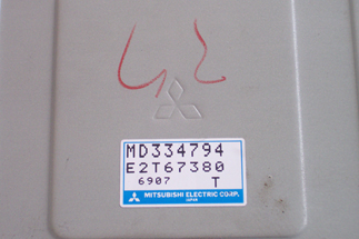

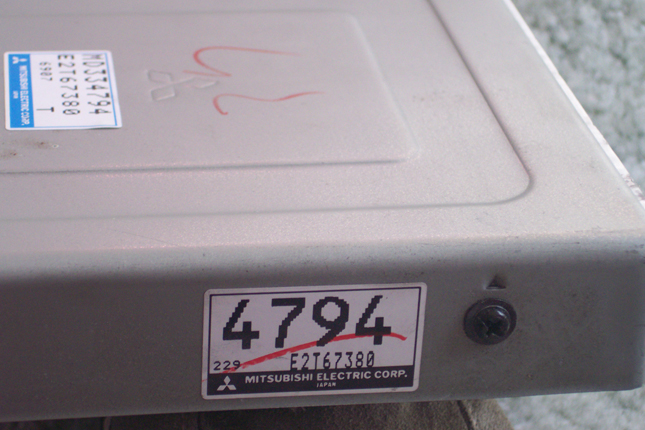

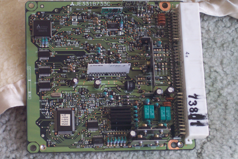

Here are the Evo 4 ECU pics, is this the same as the evo5? what connections do you hook up to reprogram these chips, which chip is it that gets reprogrammed?

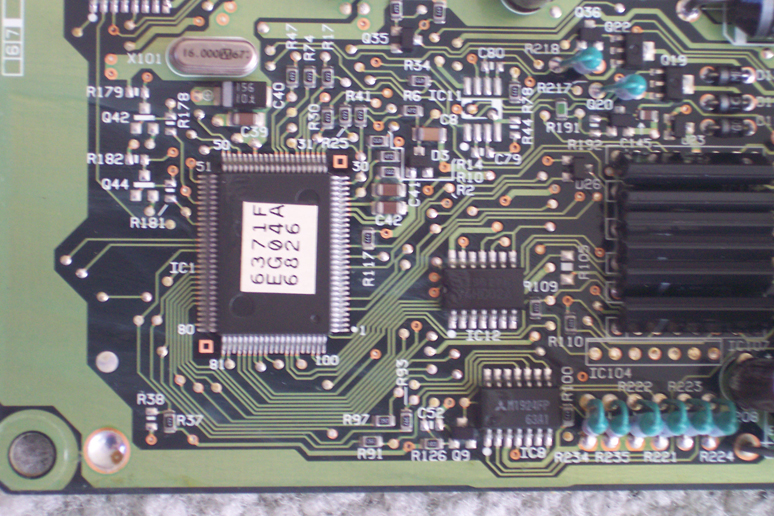

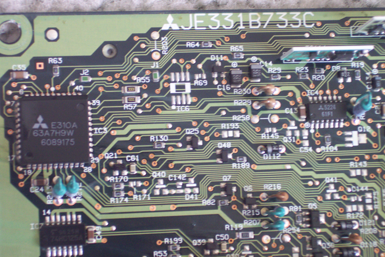

closeups of evo4 chips

I'd need to see what's written under the chip with a label. IIRC, it doesn't look like a H8/539.

The E4 ECU no where near the same as E5+, if anything it is more like E1-3 but with a MCu instead of EPROM/CPU. IIRC it is quite similar to 2G USDM Eclipse.
Thing is used E5 ECU's can be bought for less than GBP£50 and will plug straight into an E4 with a change of injectors so for the amount of development time involved I think everyones efforts would be much better spent on the later vehicles for now and anyone with an E4 that wants to do a reflash can simply use a later ECU.

cboles wrote:I'd need to see what's written under the chip with a label. IIRC, it doesn't look like a H8/539.
Just for reference...
Under the label
MH6371F
ED04
76E56F-FFFB
JAPAN 6F1282
