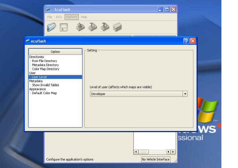

Bty, how to turn on the user level to development??? :oops: :oops: :oops:

Postby mtcavity » Sat May 05, 2007 5:09 pm
Here.
User Level.JPG (51.12 KiB) Viewed 9362 times
