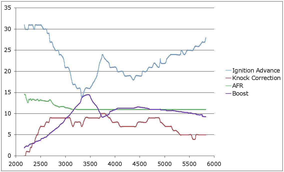

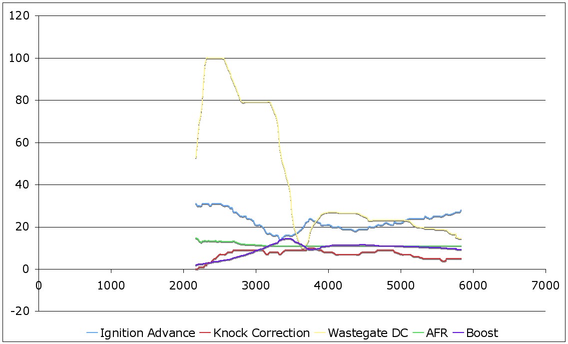

Hey ya'll... Here are some logs from my 02 manual WRX. Temperature was approx. 50 or 60 degrees, altitude is 7200ft (atmospheric pressure is ~11.2psi) Anything look out of the ordinary?
RPM   MAF (g/s)   IT (BTDC)   KC (?BTDC)   WDC (%)   (AFR)   Throttle (%)   MAP(PSI)

Postby Freon » Sun Oct 29, 2006 8:42 am
That's a bit of a boost spike. I would lower your max and initial wastegate duty in the RPM and throttle range you are in right before it spikes. I assume 100% throttle, and around 3200rpm.
Postby subgenius » Sun Oct 29, 2006 10:47 am
Thanks for the advice. I realize its not an issue of longevity (since its not boosting something insane) but is rather just an annoyance. That and I want to get the car %100 before I start to modify it. I'm posting another image, removing WDC so that the resolution of the other values is a little more apparent.
