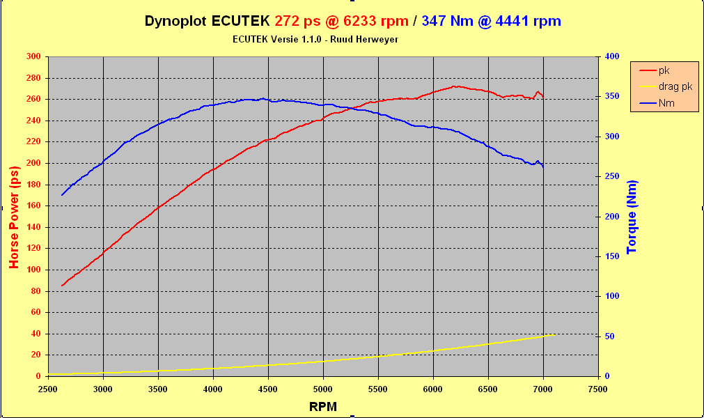

Flywheel Estimate from DD Dyno
Stock flywheel dyno.png (26.11 KiB) Viewed 5900 times

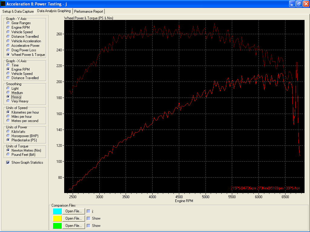

Wheel Dyno
Stock wheel dyno.png (36.5 KiB) Viewed 5899 times

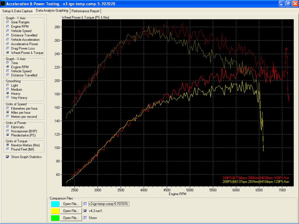

I have the lastest Dyno. I guess I can upload it. I am trying to get the AVCS sorted out.
Below is a stock AVCS v3 w/ boost < 16psi.
The yellow line is a tune Export WRX (USA tune here). Boost was just a tab over 15psi
Dyno Test: v3-ign-temp-comp-5-707070
v3 Dyno.png (42.38 KiB) Viewed 5832 times

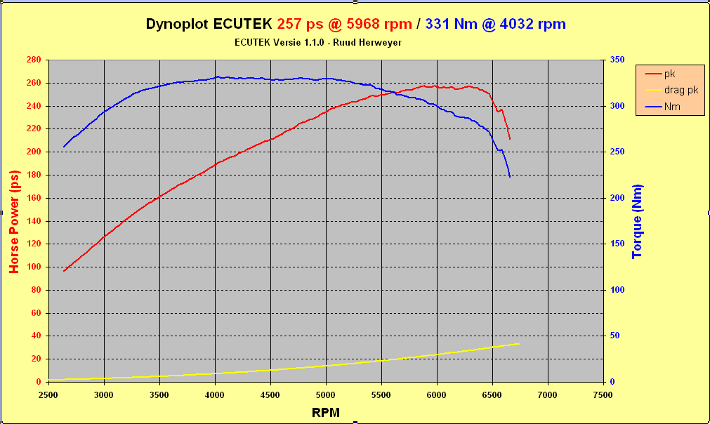

Postby west_minist » Fri Jun 30, 2006 6:21 pm
Flywheel power for above.
v3-5 dyno.png (26.25 KiB) Viewed 5809 times
