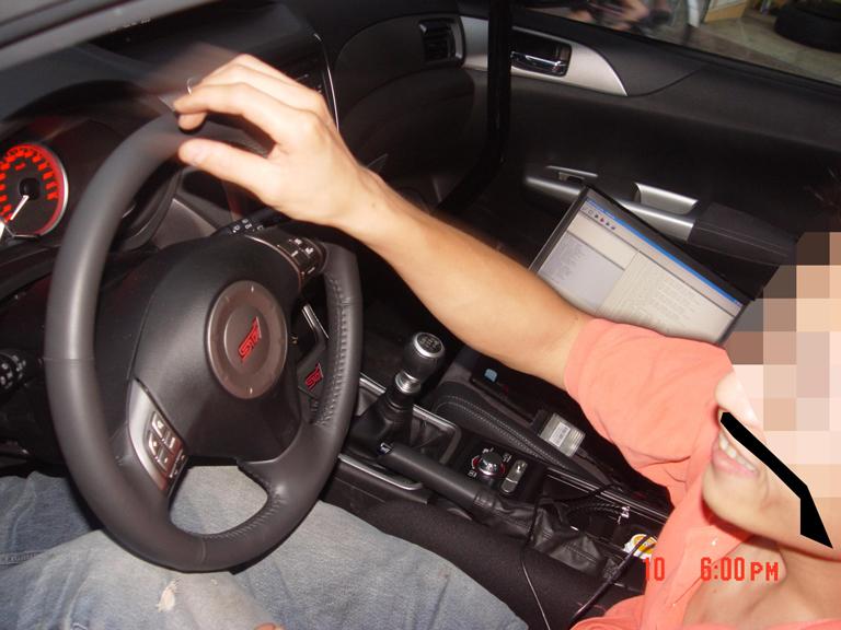

Postby mdonohoe » Thu Oct 09, 2008 11:01 pm
Hello,
Just tried with the new version, seems to be AOK, can anybody confirm? The initial failed starts seemed to be due to me turning the key at the wrong point. Who knows.
TEST Flash mode only...

Postby SonnyCosworth » Fri Oct 10, 2008 5:52 am
Flashed success.. :lol:[/img]
Last edited by SonnyCosworth on Fri Oct 10, 2008 10:17 am, edited 1 time in total.
