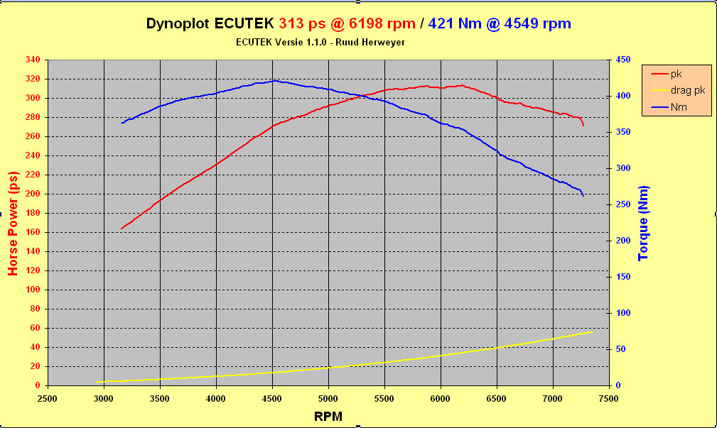

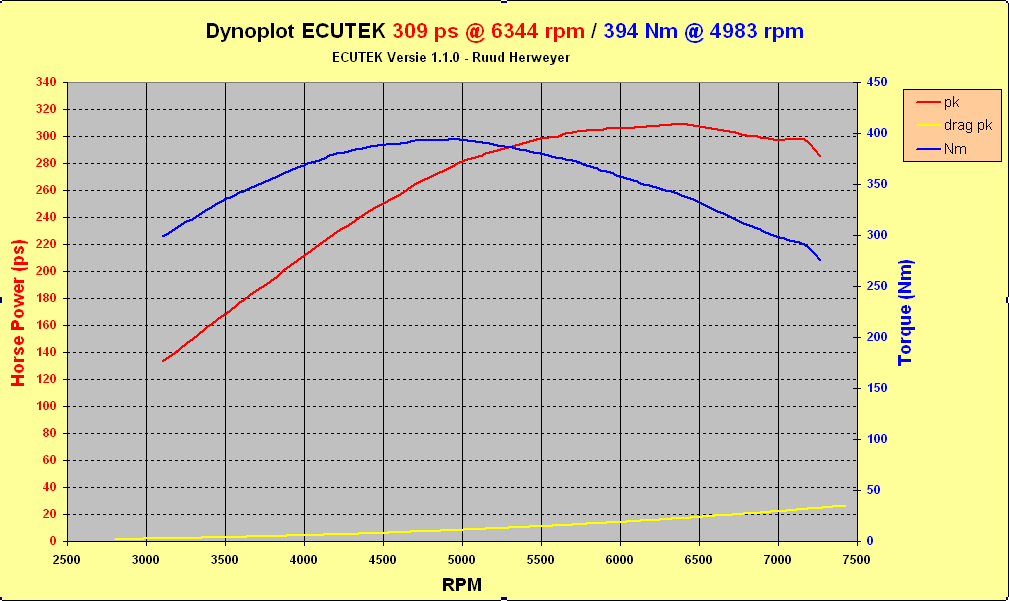

Very nice program that produce land base Flywheel dyno's.
As you can see, Spiider like going to 6k rpm and shifting, falling right back in the torque range.
The boost and the wg have be changed in revision 9 of the rom. I am awating results now. The car should spool quicker and make more torque low down and high up.
305hp @ 6344rpm / 291lb/ft @ 4983rpm
stock dyno.png (26.37 KiB) Viewed 5219 times
309hp @ 6198rpm / 311lb/ft @ 4549rpm

Postby west_minist » Fri Jun 09, 2006 10:47 pm
At present, all test was done for more torque in the lower range. Later tunes are all around :)
