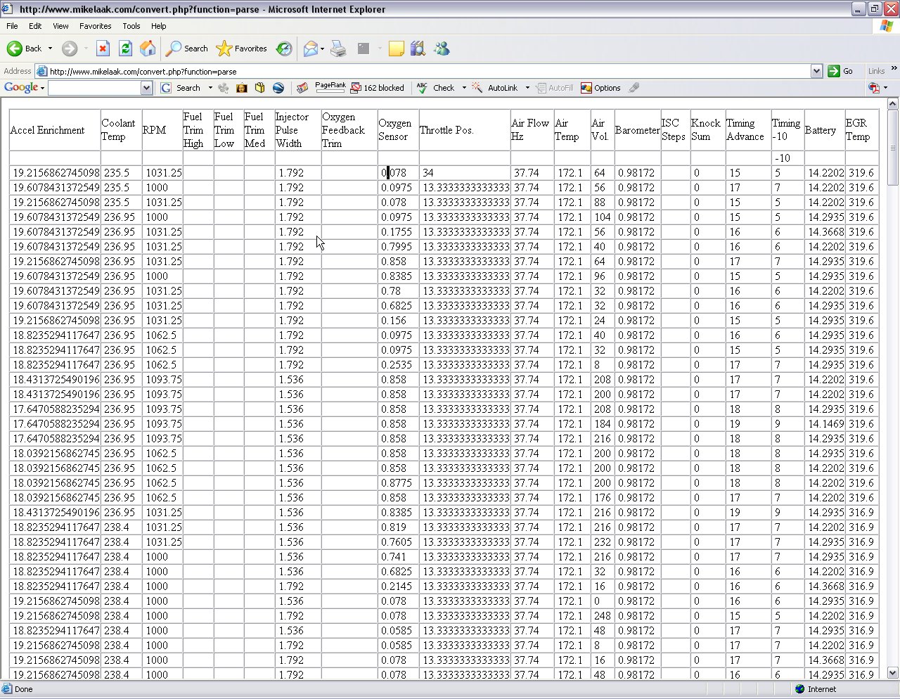

Postby andenbre » Thu Jun 29, 2006 5:21 pm
ok as for the air volume log this first shot shows the variance in reading at steady rpm and throttle that indicate closed loop o2 readings from the o2 channel and the air volume channel.

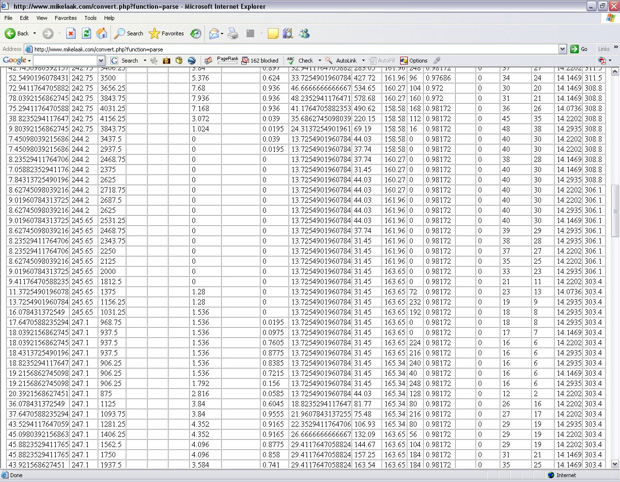

Postby andenbre » Thu Jun 29, 2006 5:29 pm
now this pic is from the same log durring decel notice how much quicker air volume channel hits 0 when compaired to o2 channel and inj pw.
I wonder if o2 is realy rear o2 (after cat) and air volume is realy front o2 (before cat). this is on an evo 9 so it may be different than an 8.
whatcha think?

Andenbre, my Evo 9 has only one O2 sensor and it reads sensible readings under O2 sensor. But it still has an "airflow" reading that behaves like yours.
Hopefully when the source appears then more people can test it in different ways. Although perhaps by editing the xml file you can already read different channels, but there are a lot to go through...
