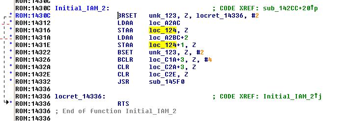

Postby NeverLies » Fri Mar 03, 2006 11:30 am
Right ;) If we use 0x20124 as IAM adress in RAM while monitoring (as laready published by some US users), we can find some routines managing IAM in the AF421 code like this one:

Postby Kha0S » Fri Mar 03, 2006 11:40 am
Jeramie wrote:Wow you guys are quick.
To bad we don't have the same ecus :(
Hopefully I will get around to "trying" to take a look. IDApro is not exactly intuitive. :lol:
Jeramie --
What CalID are you running, and what's your IAM address?
I can pull it up in IDA and look for candidates for initial IAM.

Postby Jeramie » Fri Mar 03, 2006 11:58 am
Jeramie --
AH792
A4TF500F
http://forums.openecu.org/viewtopic.php?t=94
Thats my image.
IAM 0x020120
Thanks, I eperciate it!

Postby Kha0S » Fri Mar 03, 2006 12:58 pm
Looks like 0x2998D. Can't guarantee it, but try it out. Change it, flash, and pull IAM to see if it's changed.

Postby Jeramie » Sat Mar 04, 2006 8:57 am
I got a chance to edit the hex and flash the image and it work perfectly. 8) 8)
AH792
A4TF500F
Inital IAM Address = 0x2998D
