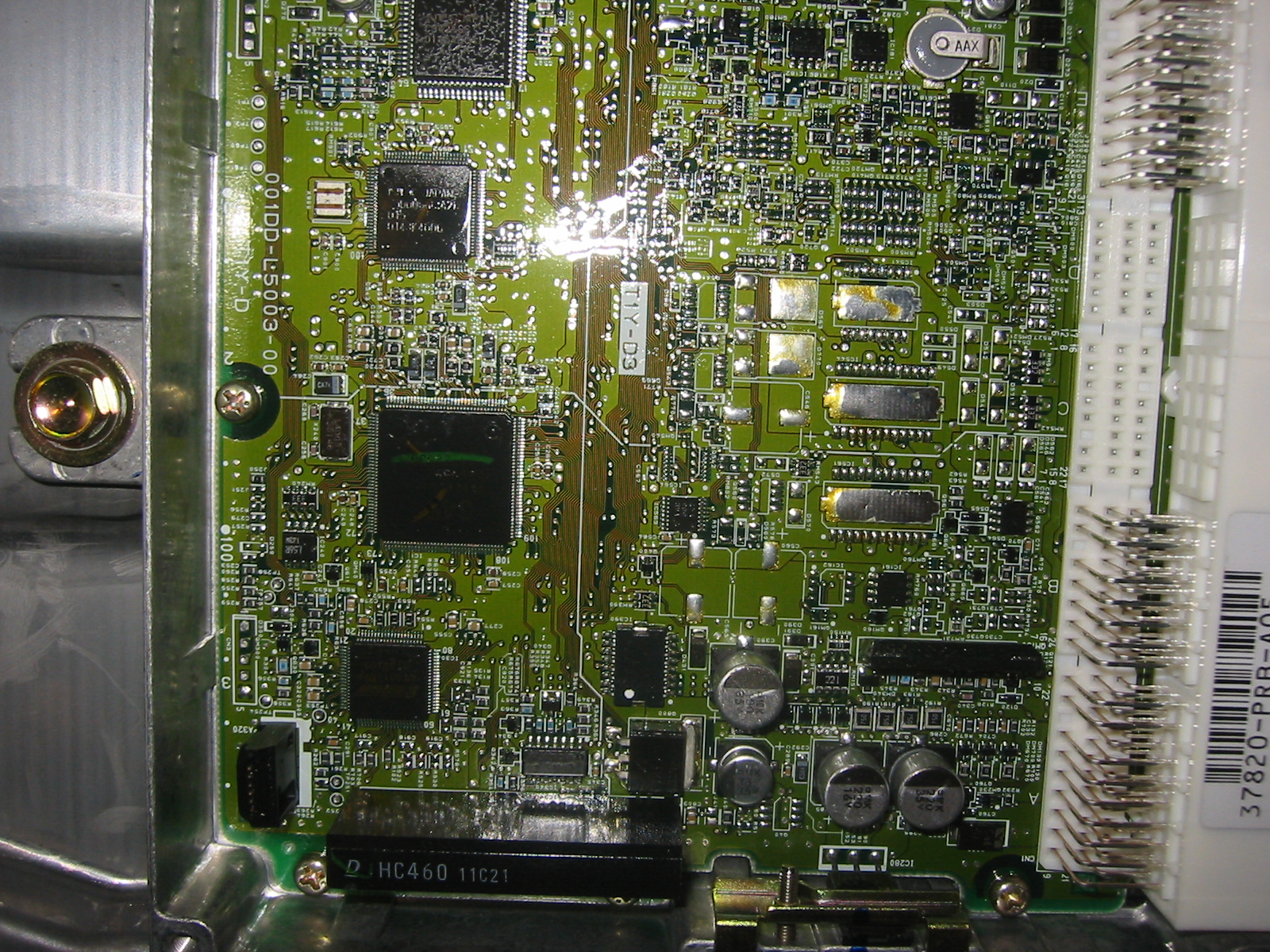

Postby qoncept » Sat Feb 25, 2006 9:13 am
Alright Colby, here's the best we could get..
The main CPU has 144pins and the following printed on it:
645
0KI JAPAN
L660592
147225362
I'm not sure exactly what else you need, so let me know if I'm missing anything important. I don't know what the crystals you're talking about are, and I'm also not sure where the power source is grounded.
Postby qoncept » Sun Feb 26, 2006 8:13 am
Hmm.. yep. I thought about it this morning and thought I might have forgotten to attach the image..
It's not that great, but I can answer questions if you have any.
Postby cboles » Mon Feb 27, 2006 8:43 am
My guess is that it is an OKI ML66Q592. Here is the datasheet. It would be nice to look at a lot of Honda ECUs to see how much the processor they use varies from car to car and year to year.
ml66592_ml66q592.pdf
OKI ML66592 CPU datasheet
(114.45 KiB) Downloaded 1806 times

on the board above in the pic
Postby jak » Sun Mar 19, 2006 10:22 pm
I see what looks like a 10 pin BDM location?
you may be able to solder a 10 pin BDM header onto that bad boy
I could be rong Id like to see one myself
what is that ECU from specifically?
JAK
jak
Posts: 37
Joined: Sun Mar 19, 2006 8:23 pm
Location: black mountain NC
Postby qoncept » Mon Mar 20, 2006 6:38 am
jak, that's from a 2002 RSX Type S. I'd really like to avoid having to solder chips on it -- OBD-II says you don't need to do that.
