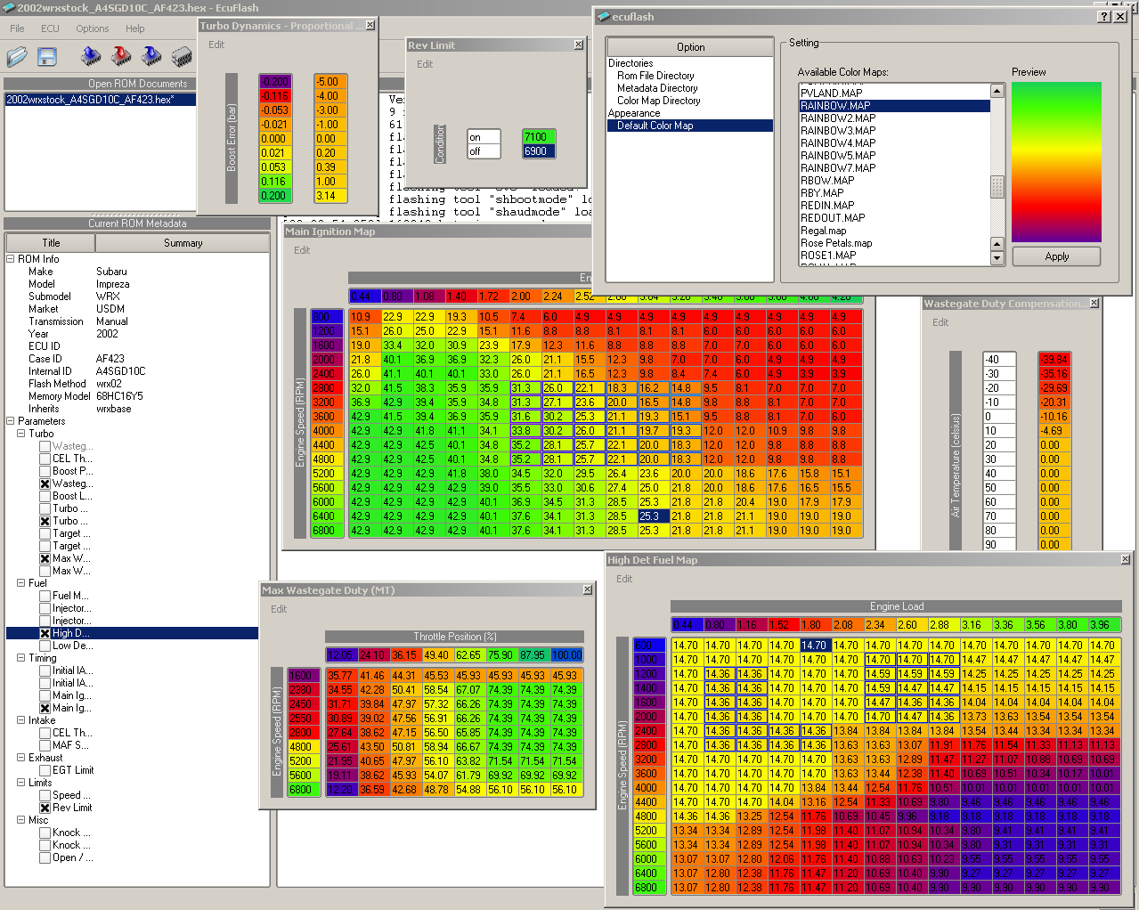

First, let me say that this is BETA software with insufficent testing by me - which is why I'm posting in hopes that I can get some people to test it out :). This version of EcuFlash allows you to edit maps, and I'd love to have some people volunteer to try it out and let me know if they find any problems. I have most of the correct offsets programmed in for the 2002 WRX ROM A4SGD10C which can be found here:
http://forums.openecu.org/viewtopic.php?t=63
Playing with this ROM can serve as a good example of how to setup the ROM definitions as well as be a quick way to load something and try the editing features out.
Here are some of the editing features I have added in this version:
* user selectable color legends in the options menu
* cut and paste to Excel and between maps
* multiple selection using click, drag, ctrl-click, etc.
* cell highlighting to show changes from original ROM
* infinite undo / redo on a per map basis (might limit this in the future if memory becomes a problem)
* increment / decrement (amount is defined in the scalings)
* 1% increase / decrease (may have no effect if the display equation is too granular)
* set / add / multiply (you can actually enter arbitrary equations as a function of "d" at the "set" prompt - e.g. d="d*2+1")
* horizontal / vertical / 2-D interpolation
* revert selected area to original values
Please give it a try and let me know what you think...

It's just the map editing functions. Even those functions are somewhat reliable in a WYSIWYG sense. Whenever you make a change to a cell, it changes the underlying ROM representation, and then redraws the cell based on the ROM data, so you can be pretty sure that you are getting the changes you are expecting. Like any map editor, your changes are only as good as the map definitions, so you have to be sure the formulas and addresses are correct.
I'm not sure where any bugs are at this point (or I would have fixed them), but it's possible the application could crash or fail to edit something in the way you expect, but like I said, that should be visually obvious. One thing that is missing at this point is that there is no interlock to prevent you from editing maps that are in the process of being reflashed. Obviously, that is a no-no.
I'll add a 2-D / 3-D grapher very soon - it should be fairly simple to do.
