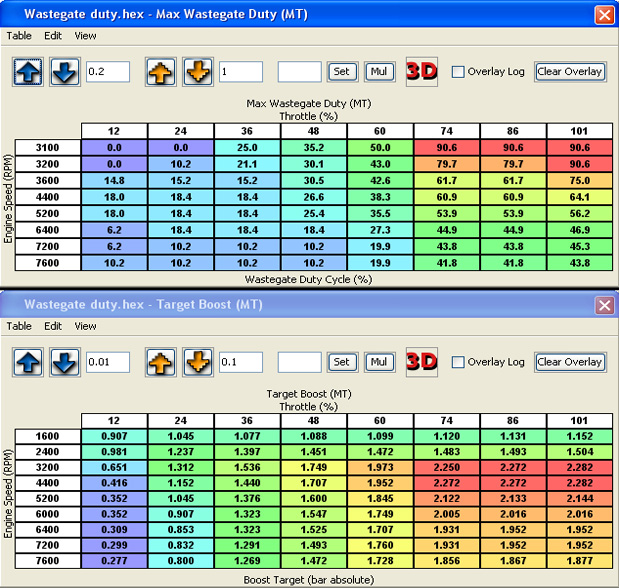

I'm looking at the Ecu image on my JDM STi7 using Enginuity but first I recorded a log in second gear. I have a couple of questions to ask but first please look at the following.
I run her Steady @ 3150 rpm in second gear then foot hard to the floor.
Log shows low boost of 0.41 bar until the rpm hit 4074rpm :(
the boost increased to 0.74 bar @ 4074rpm and increases quickly
to 1.241bar @ 4908rpm.
Question #1 Why was the boost so low between 3500rpm & 4000rpm :?:
Question#2 Could you look at my Max Wastegate duty & Target boost maps
Would you say there a little tame around midrange :?: ie around 3200 rpm
Target boost on the pic includes atmospheric pressure
Thx for your time lads (lasses) :wink:

Postby dynamix » Sun Nov 25, 2007 1:27 am
What are your init wgdc and TD positive maps like?
I presume you have checked for leaks?

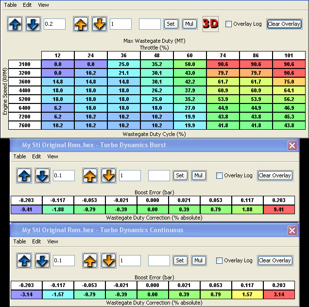

Postby r6_yamaha » Mon Nov 26, 2007 4:01 pm
Hi again
Here are three pictures.
Top Wastegate duty cycle %
middle Turbo Dynamics Burst
Bottom Turbo Dynamics Continuous
I'm not sure what one you exactly want to see when you say
initial wastegate duty cycle, so if ive put the wrong one then let me know.
Id like to say thank you again for helping me out.
Cheers.
I see what you mean when you say 3200 is not tame so would you say it would have been lag, regarding my first question in the first post?

Postby dynamix » Wed Dec 05, 2007 2:19 am
What turbo is this ?
Seems very excessive for lag.
