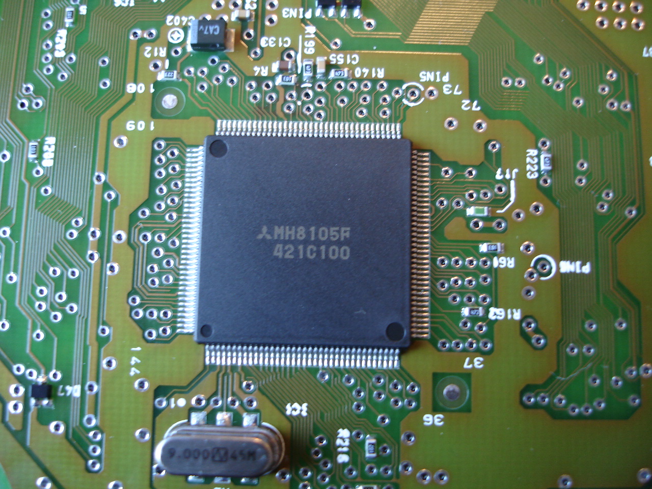

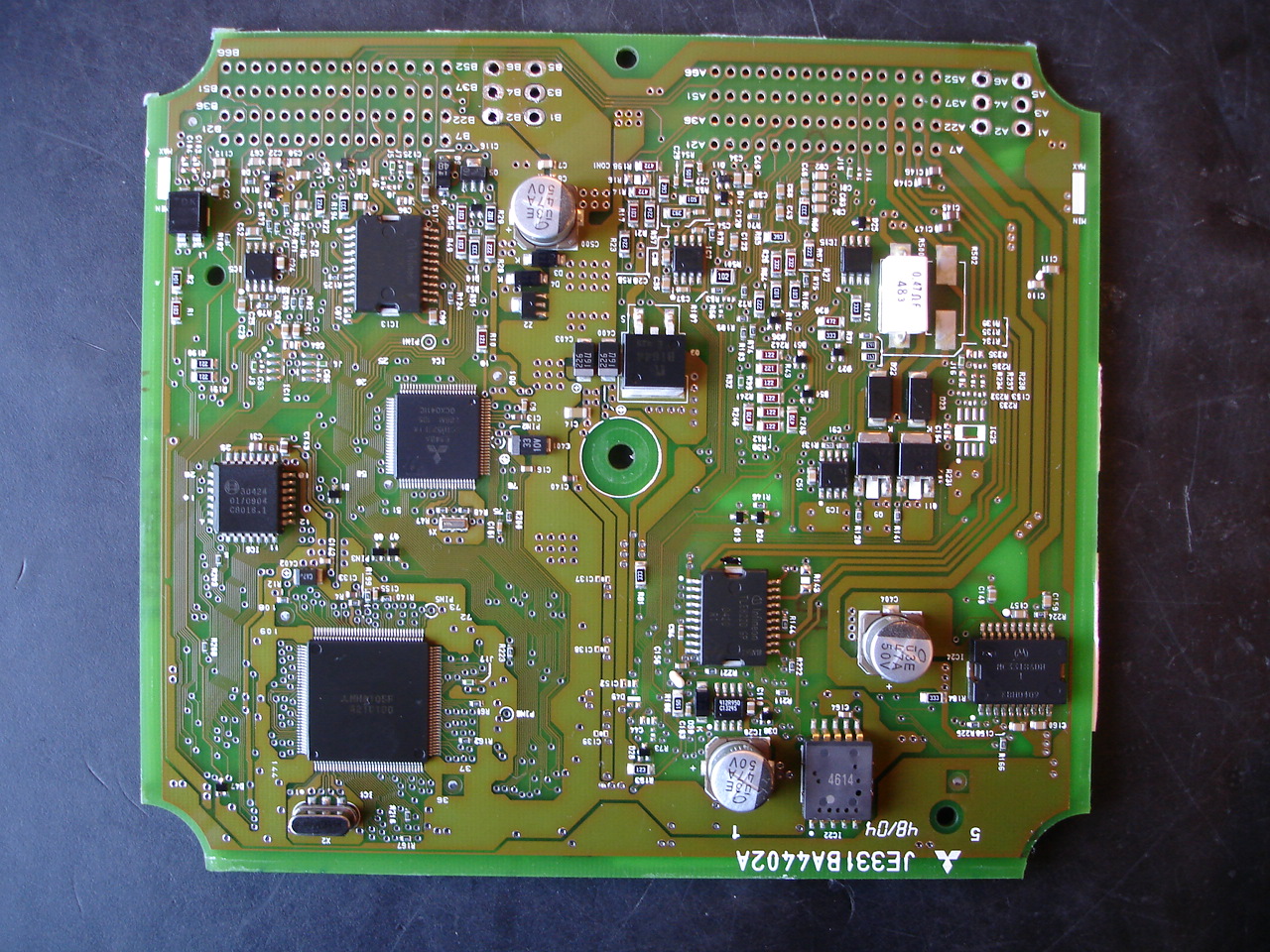

Hi @ all,
There some news about the Colt CZT 1.5,
Just now I have read the stock rom.
I put here the stock ROM and some picture of the MCU.
Maybe someone have other resurce...... ;-)
regards
Christian

Must've been fun desoldering the ECU connector.... what's the story there?

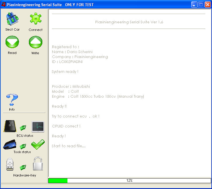

Hi @ all, the flashing of the MH8105F is done.
regards

Has anyone identified the micro yet? MH8105F is an internal Mitsubishi part number/cross reference; who's chip is it and what is it?
I believe it's either ST10 or Renesas, not sure the exact variant. 512k flash.

Has anybody identified the chip yet?
MH8105F is just the part number for mitsubishi.
Perhaps it is an SH microprocessor, just like the rest?

I think it's m32r cpu, uses Kline and 16v to boot.

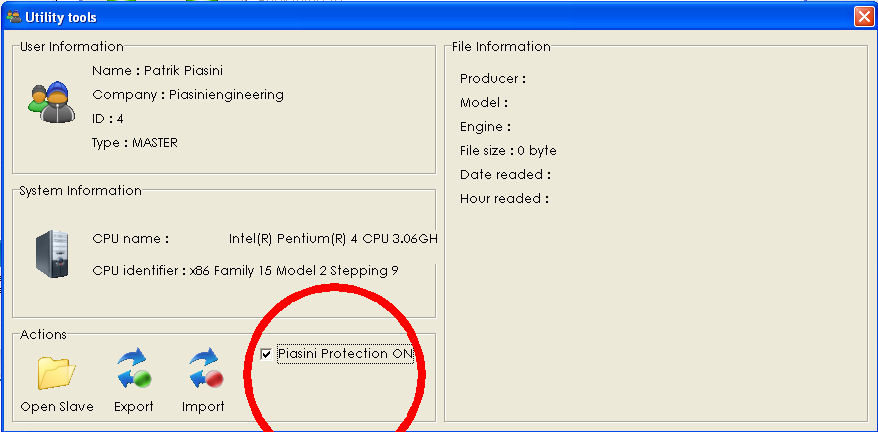

Hi @ all the members
Postby christian_piasini » Mon Jan 14, 2008 10:27 am
Yes it is possible to copy complete dump to one other ecu.
Right now we done more then 100 Cars all arround the whole world trough our dealers.
On the colt CZT 1.5 i see just 4 different stock dump.
It is also much similary the FourFor Smart 1.5 177HP.
Trough our device is also lock the file inside, so can't read it anymore other then us Headquarter.
Best regards
