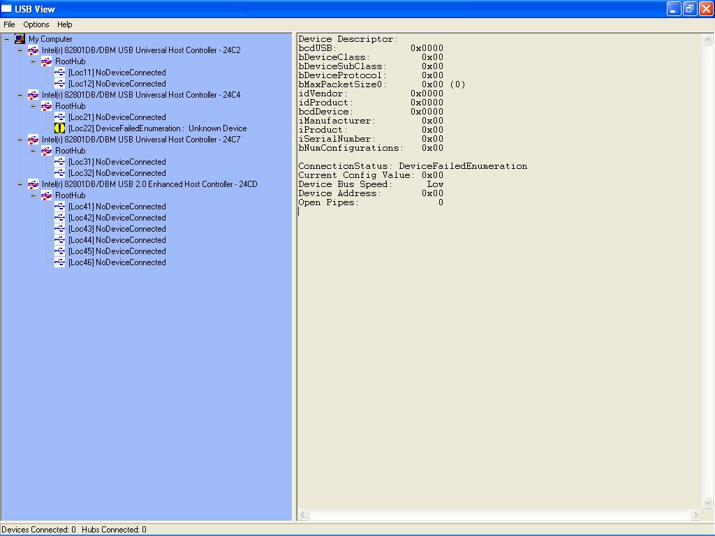

Postby west_minist » Mon Oct 17, 2005 6:23 pm
LOL.
I tried the wrx cable on two IBM T41 and my computer.
As you can see from the USB viewer, there is a problem, for which I opened a case with FTDI, which is closed now.
I have other USB devices that are still working, but unlike them, I keep the cable in the car.
I start the car and then plug in the cable.
Sometimes I turn of the car and then unplug.
I always keep the cable role up in the form it comes.
Well, I will try one last time.
I will purchase the new cable sometime soon, otherwise, I will try and see if I can get a AP one.
tactrix cable problems.jpg (92.65 KiB) Viewed 5819 times
Postby west_minist » Mon Oct 17, 2005 6:49 pm
I just purchase the new cable.
I will see how this goes.
The only thing I can think about is that my ECU is damaging the cable or excessive heat in the car.
Everthing single computer I use the cable with does not recognise it.
I have a JECS ECU.
