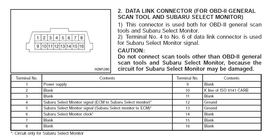

Postby yarikoptic » Sat Apr 02, 2005 10:42 am
uploaded image (from the same 1995 manual) says that pin 11 is not loaded... so hopefully it is so... the last check - is check under dash board if really 11 is not loaded :-)

Postby yarikoptic » Mon Apr 04, 2005 6:55 am
yarikoptic wrote:uploaded image (from the same 1995 manual) says that pin 11 is not loaded... so hopefully it is so... the last check - is check under dash board if really 11 is not loaded :-)
I checked from the inside of the dash board -- I have wiring exactly as picture says :-) So I assume I'm safe :-) now I can order :-)

Postby cboles » Mon Apr 04, 2005 9:32 am
The wiring diagram you have posted is interesting - it looks like there are pins dedicated to the SSM protocol whereas on the WRX you just do SSM over the K-line. Are you able to do SSM on the K-line of your vehicle, or only OBD2 stuff?
