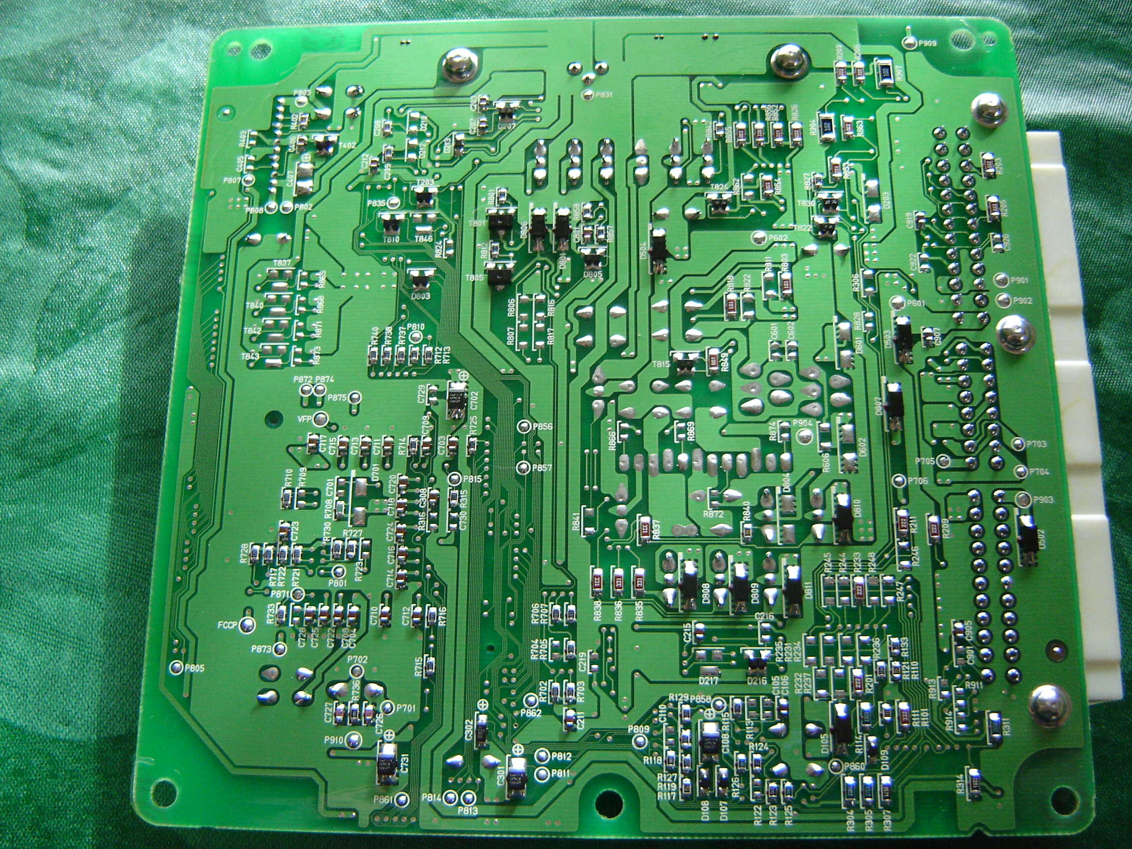

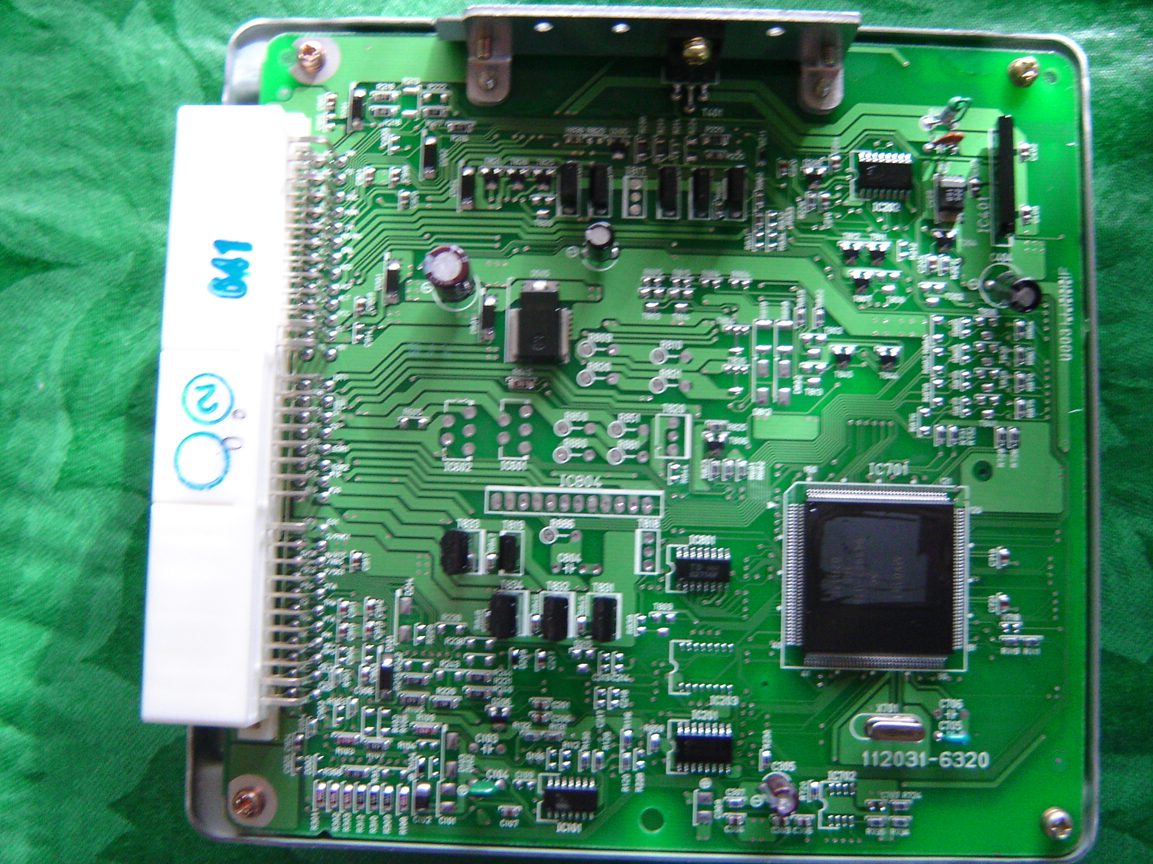

In addition to Rhinomans accomlishements thus far I have taken photos of the factory ECU in my 2000 model Suzuki Baleno 1.6
NOTE: These cars are known as Suzuki Esteem in the USA.
I hqave uploaded the main pictures of the ECU but have the link to where more are saved detailed below.
The main processor chip inside is manufactured by Motorola.
It has 160 pins.
The details I read off the chip are as depicted below.
MY0151
"M" (Motorola Symbol)
949927-0151
185
02B11C
I have Googled the details of the chip but have had no luck.
I am led to believe from my previous experience that many chips are made exclusively for the end user. In this case Denso / Suzuki.
Thus no info is publically available... No datasheets...
As Rhinoman has pointed out to me thse look like 68HC16 / 68HC916 chips.
Bottom View of Baleno OEM ECU
Baleno ECU 006.JPG (1.73 MiB) Viewed 2792 times
Top View of Baleno OEM ECU
Baleno ECU 004.JPG (1.64 MiB) Viewed 2793 times

Postby Rhinoman » Tue Jul 22, 2008 8:04 am
I have the same PCB in a UK version but the processor has what seems to be a more conventional Denso part number beginning with DS151807. I did request the BDM driver package for AN1230/D from Freescale but they say that they no longer support this.
