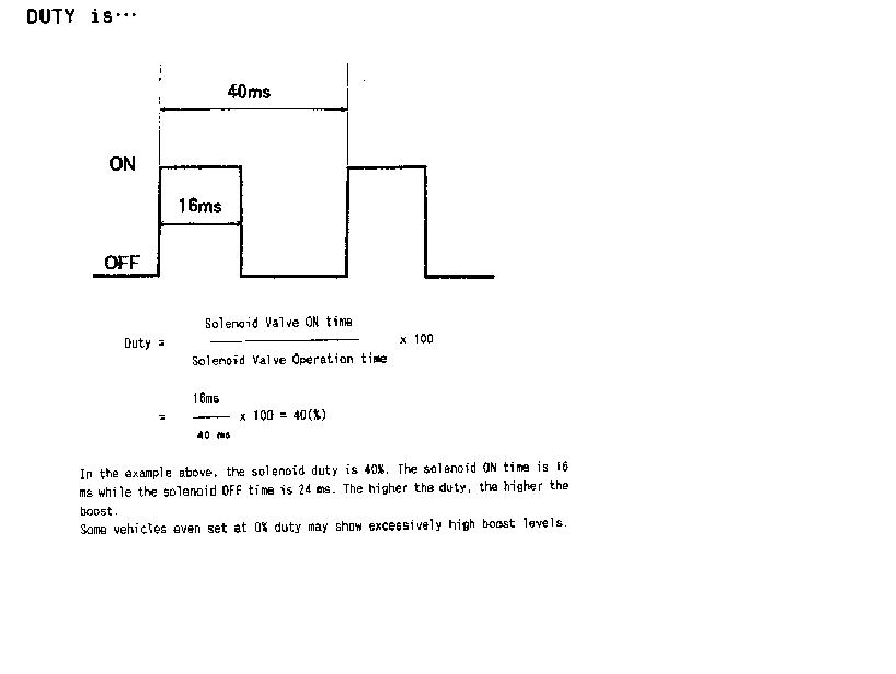

Postby mtcavity » Wed Jun 20, 2007 8:35 pm
I got this from the APEX'i manual I own. Is this the same idea for ECU Flash?

Our cars use a single pneumatic boost control solenoid with a PWM control. Wastegate duty is the % on-time for the PWM signal.
