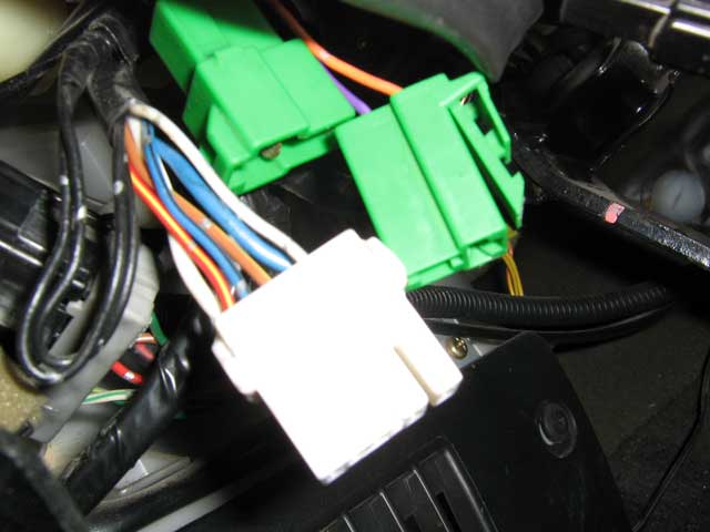

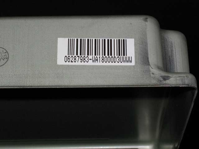

Hi ! I have Legacy B4 RSK from Japan BE5 2000 year. And my problem - where is a flash connector ? Green connector is ok. Logging is ok. But read ECU is not possible. Thanks.

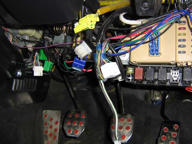

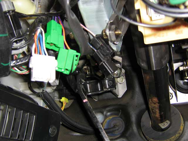

from you find the green connectors under the dashboad, you should see the white connector. then again your car is a 2000 so you might not use them.
swiffly
Posts: 35
Joined: Sat Sep 09, 2006 12:25 pm
Postby bb8 » Wed Dec 13, 2006 12:18 pm
I have found a white socket, but it is not similar on necessary. In it six wires.

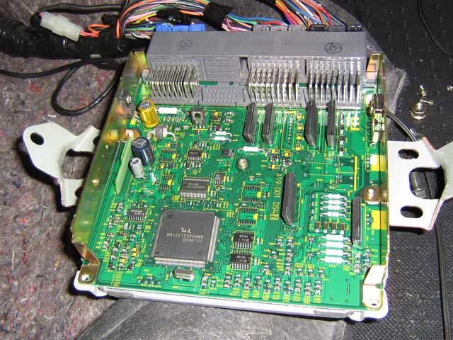

I tried to read out ecu 8 times at the closed green sockets - it is impossible, the program gives a mistake ssm2 x081 . I have opened ecu and have looked near to it - no other sockets are present.

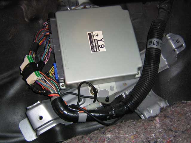

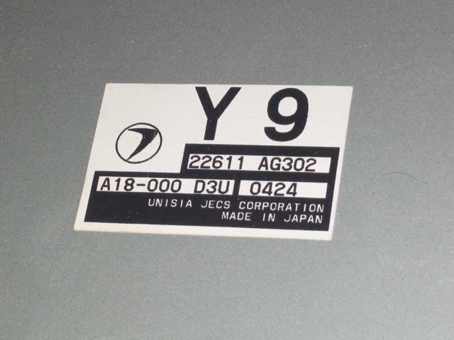

Program EcuExplorer defines type ecu as MY99 AG302, I think, that this type concerns to cars of type Drive-by-cable, and for them is necessary flash connector.

that the type ecu UNISIA JECS which costs at me in the car, cannot be read through by means of EcuFlash. It is the truth? What to do?

Also see the end of this thread for JECS ECU status: http://forums.openecu.org/viewtopic.php?t=192&start=210

JECS ECUs are not readable by EcuFlash at this time.
