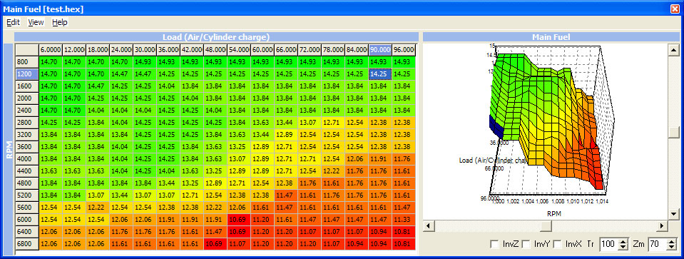

Postby xswrex » Mon Mar 27, 2006 4:08 am
this looks like a main fuel map
LOAD @ 0x136f
RPM @ 0x137f
AFR @ 0x138f

Postby Hitokiri » Mon Mar 27, 2006 5:46 am
xswrex I agree
I am not sure of the conversions I used. RPM seems to be right in the normal *50 conversion. Load is unsure at this point as we cannot be sure what these ecus use for load. I know I have a engine load parameter that shows up in my ecuexplorer that is 0-100% so I simply did [value]*2 to get data that looked good for that scaling.
The data conversion was a guess too keeping the convention of the ecuedit tools with: 14.7*(128/[value]) seemed to be simple enough and give good results.
Here is the map in question:
Fuel Map from UK P1? Tuned?
Postby STi6 » Tue Mar 28, 2006 12:40 am
These ECU's use a combination of factors for load according to my tuner. Some of these factors are, MAF sensor g/s. Throttle position and maybe some others.
I was in my car yesterday when it got tuned and the Load Values are all numbers with decimals, not real numbers like 50,60,70 etc.
STi6
Joined: Tue Jun 28, 2005 6:07 am
