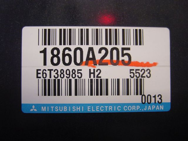

ECU pictures adn Dyno bench Test
Postby christian_piasini » Wed Dec 06, 2006 11:53 pm
Hi @ all, some additional info on the Outlander ECU EDM
I take some picture and I try the car on the dyno bench.
bye
