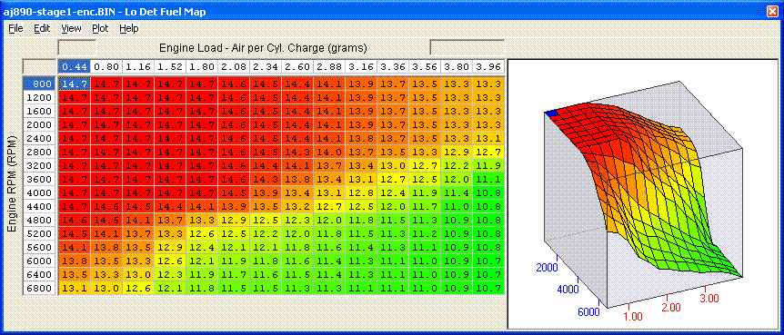

Here is a screen capture from the E**Tek software...
I could be 100% wrong... but with as anal as they are, I don't think they would mislabel an axis.

I believe I need to understand how the load(grams) are calculated.
So we are looking @ mass air flow - g/s
Maf voltage - v
Load - g

Guys, that is correct. MAF voltage is converted to load, which might as well be unitless as far as the ECU is concerned. It just takes that load and looks it up whereever load is used as an axis on a map (mainly timing and fueling). It seems to be approximately exponential. There is a 2D Map that is 87x1 (or whatever, it is long!) with an 87x1 column header on the last WRX ROM I looked at.
FWIW, I think a lot can be done to tune intakes by adjusting that table. Once I get into it, I will be using the MAF to load table to flatten out fuel trims to adjust for my intake.

x99percent wrote: I could be 100% wrong... but with as anal as they are, I don't think they would mislabel an axis.
Ah, no, you're correct, the axis isn't mislabeled, but we are talking about different units.
The MAF sensor, located where it is, and being the design it is, by definition measures the total amount of air being pulled into the engine. Hence grams per second being the quantity used by the SSM stream, MAF scaling table and so-forth.
The ECU map you quoted uses grams of air per cylinder per charge, so they're dividing the total g/s figure by engine speed and so-forth.
