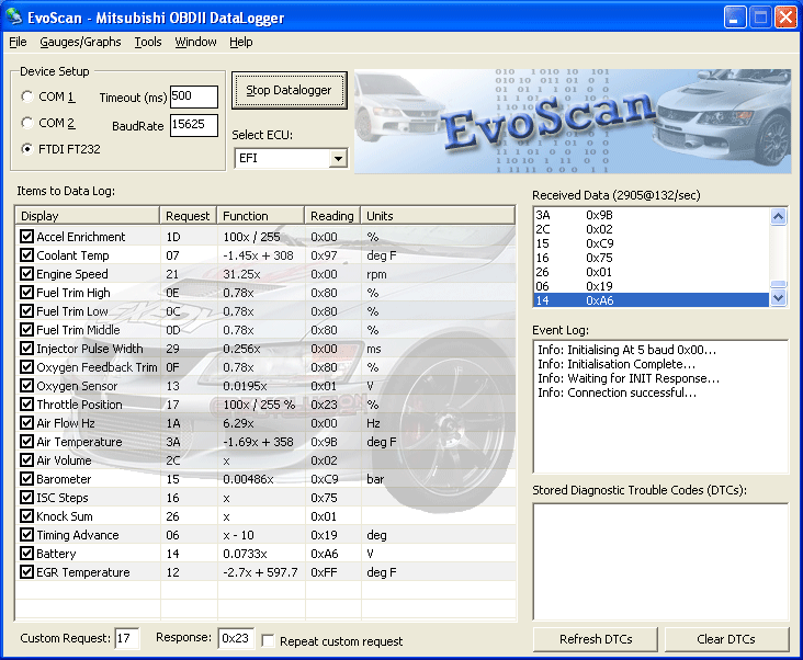

Screenshot of an early version of the application running on my Evo 4. Getting good scanning speed of 120->130/total samples per second, even though the openport cables are a little slow letting go of the packets from its buffers. As shown by the indicator in the screenshot it is writting full logging at 132/total samples per second, which is damn fast for logging!

That looks really nice! I can't wait. Very high sample rates so props for that.

My 1.3 cable just arrived and I hope the software is out soon. The screenshot was such a tease ;)
