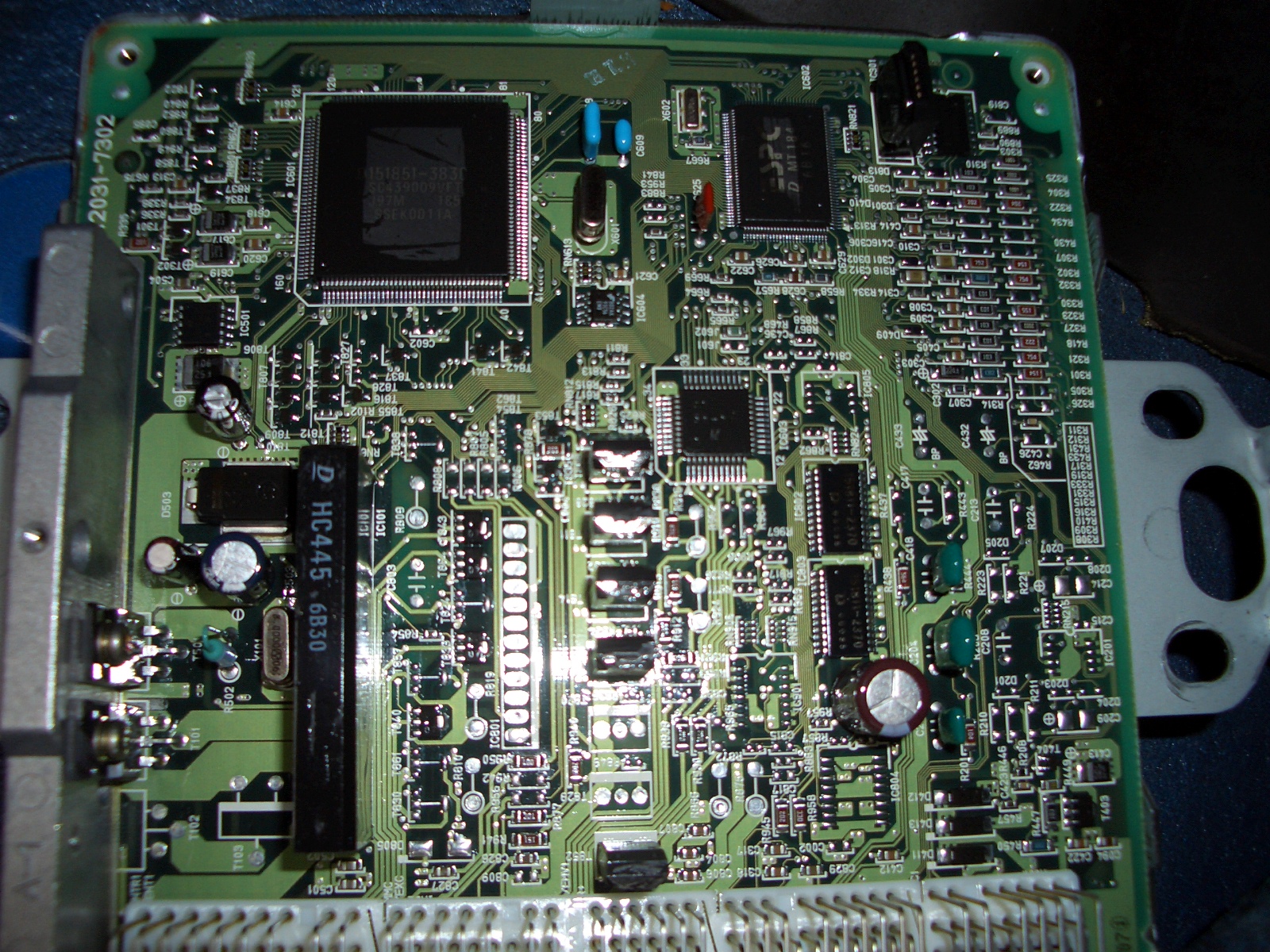

By the way, here is a pic of my ECU (AF530)...
Does anyone know what IC602 is ("ESPC")?
Does anyone know what IC603 is (44 pin quad jobbie in the middle)?

Probably a really dumb question, but I had originally assumed that the program flash memory was internal to the HC16, but from the Freescale HC16 variant comparison page, none of them seem to have much flash. Are those two 24 pin dil packages (IC 802, 803 on my PCB) flash memory?
What is the the 44 pin IC603 next to these ICs?

* the flash is internal
