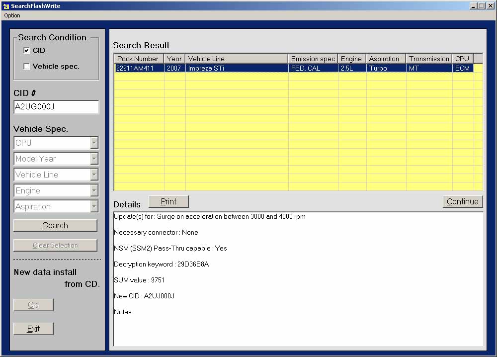

I have Subaru's CDROM and I've attached a screenshot of the results of a search for updates to calibration ID (CID) A2UG000J, the base flash on the US 2007 STI.
The "Decryption keyword" business sounds ominous.
Screenshot showing which .PAK file has an update for the 07 STI calibration ID A2UG000J.
