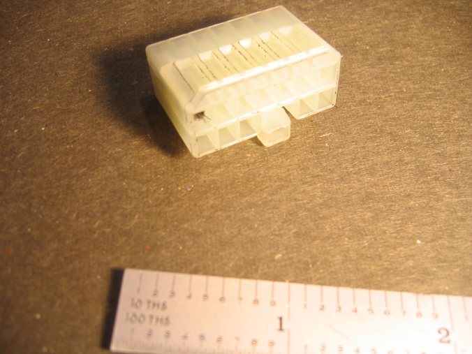

Does anyone know where I can find this EVO connector?
Developer topics relating to hardware that interfaces PCs to ECUs
Postby cboles » Wed Nov 02, 2005 11:04 am

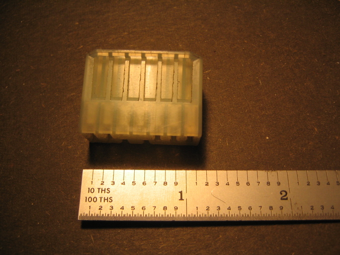

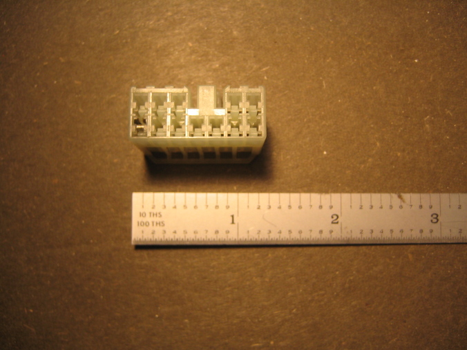

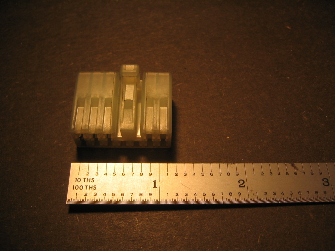

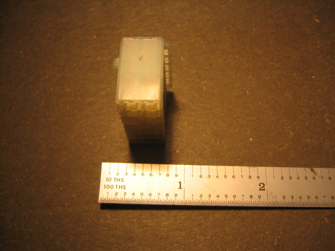

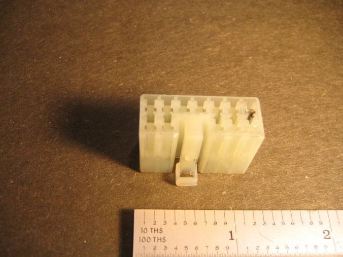

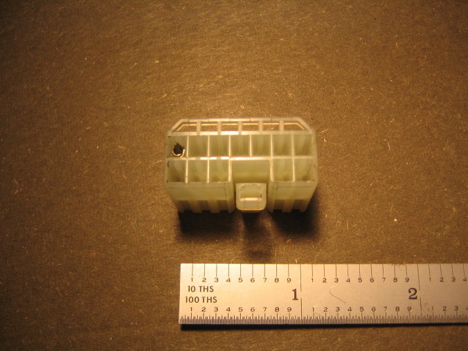

I'm trying to find a source for this EVO connector which is used to put the ECU in a special mode where it can be reflashed. I don't see any distingushing text / symbols on the connector which would reveal the manufacturer. Does anyone know who makes this or where I can get some?
Postby cdvma » Thu Nov 03, 2005 7:54 am
Looks like a Molex, but then again a lot of things do. I'd get a catalog (or online) from Mouser or Digikey they have pages of pictures of connectors.

looks very similar to this one off the old legacy. missing 2 pins though, but might be same manufacturer?
http://www.graphics.cornell.edu/~v/bcbfscan/
Postby cboles » Tue Jan 03, 2006 4:03 pm
Found it! It is a Sumitomo F(6244-5121) 12-way connector listed on page 3 of the attached PDF. Socket pins for it are on page 2. Special thanks to Thomas Dorris of ecmtuning.com for letting me know that it was a Sumitomo part.

Postby GTODesign » Mon May 15, 2006 12:30 pm
Does this connector tie to pin 79 on the ECU side?
GTODesign
Posts: 81
Postby GTODesign » Tue May 16, 2006 4:10 am
Just tried it and it's definately tied to pin 79 on an E7 ECU.
