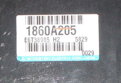

Has anybody actually been able to successfully read the EDM Outlander ECU using EcuFlash?
We were trying it on a 05 2.0T Outlander yesterday and it was not possible, we were getting "...no response to any known code".
The car's extra connector has two wires, a green and a purple.
We connected the Tactrix extra black cable to each and both of them, using EcuFlash 1.29a and the latest version. No luck.
Eventually we got an error code, P0606 - ECM/PCM Processor, but we cleared it and the car ran fine.
EDM Outlander ECU Code.jpg (61.48 KiB) Viewed 2480 times
