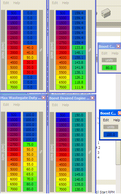

Hi folks, this is my first post so be patient.
Which values do I alter to get my JDM E8 MR to hold full boost ( around 21PSI ) after 5000 rpm I have had it on the dyno and it just falls off most people in Australia are running electronic boost controlers, I have purchased the cable and read my rom and beleive I should be able to manage my boost with ecuflash. TIA,
Brad.

8MR - yours on top, one I tuned on the bottom.
Wastegate duty on the second solenoid (in the def I put on here #2,3,4)
Boost desired engine load
Boost control load offset
Load target is the sum of boost desired engine load and boost control load offset.
You have two restrictors before the solenoids - if you run out of duty (both at 100%) you can get more boost by removing.
You should be able to get 22 PSI at 6000 RPM.
