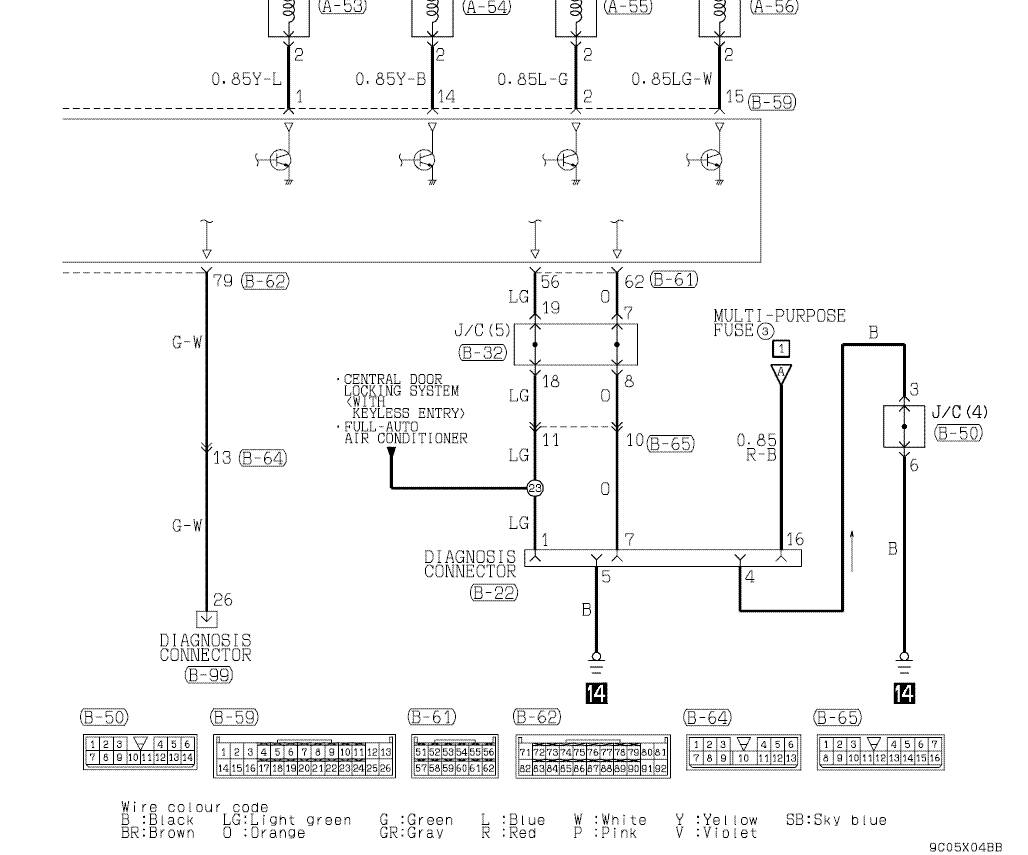

I am going to try and write my own kernal and flash program for evo5/6... YP and Colby if you could give me a hand that would be awesome.

Evo4mad that would absolutely, positivley undoubtedly be GREAT. However how would solve the second problem, which is the second connector that pre-evo-7 do not come with.

lol, I just posted a pic of the second diagnostic connector wiring diagram, and I get a question like that.. hehe. Do I have to get a camera out too :) take a look again... B22 and B99 (looks like 2 connectors to me)

ok I'll find where that connector B99 is located and you can take a pic for me..
B-99 Connector, EV6 Definition Files Anyone
Postby KanScooby » Fri May 02, 2008 5:49 am
Hi all, thanks for all the great info... got me downloading the EVO6 ROMS and datalogging using Evoscan. Can't look into ROM yet as I have no def files....anyone with some I'd appreciate.
The B-99 connector is taped close onto the harness close to the OBD connector.

My E6 RS2 has the B99 connector, it's a white connector with only one wire.
