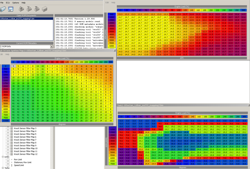

TTP Engineering in the US runs 32 PSI and high 10s at 130 mph on stock engine and turbo. He won't hold 32 PSI at red line of course.
race map
Postby flash » Tue Dec 12, 2006 3:19 pm
in the attachment you see a map from a jp-streetdriver.
modifications on the car:
- 90mm exhaust (with 90mm downpipe and testpipe)
- selfmade 80mm outlet
- ported stock turbo
- piping kit and big intercooler (a little jp-company)
- open intake
- a 272exhaust cam
- ex. manifold (selfmade)
- a 270l/h pump
the car run at a boost of 1,6bar (at redline 1,5) with MBC.
he use 105octan RON-gas only.
sometimes knockcount of max. 3 at a egt of max.920°C.
(the mapping is not the final edition but nearly complet)
