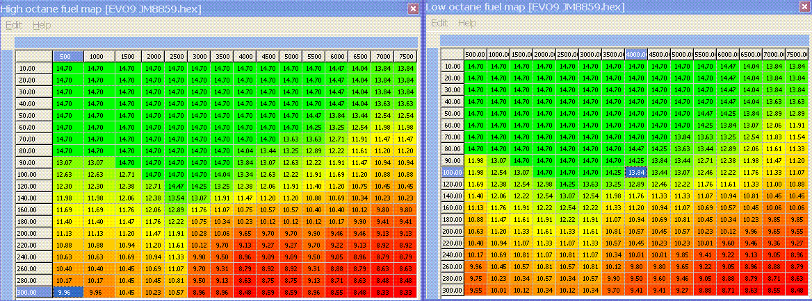

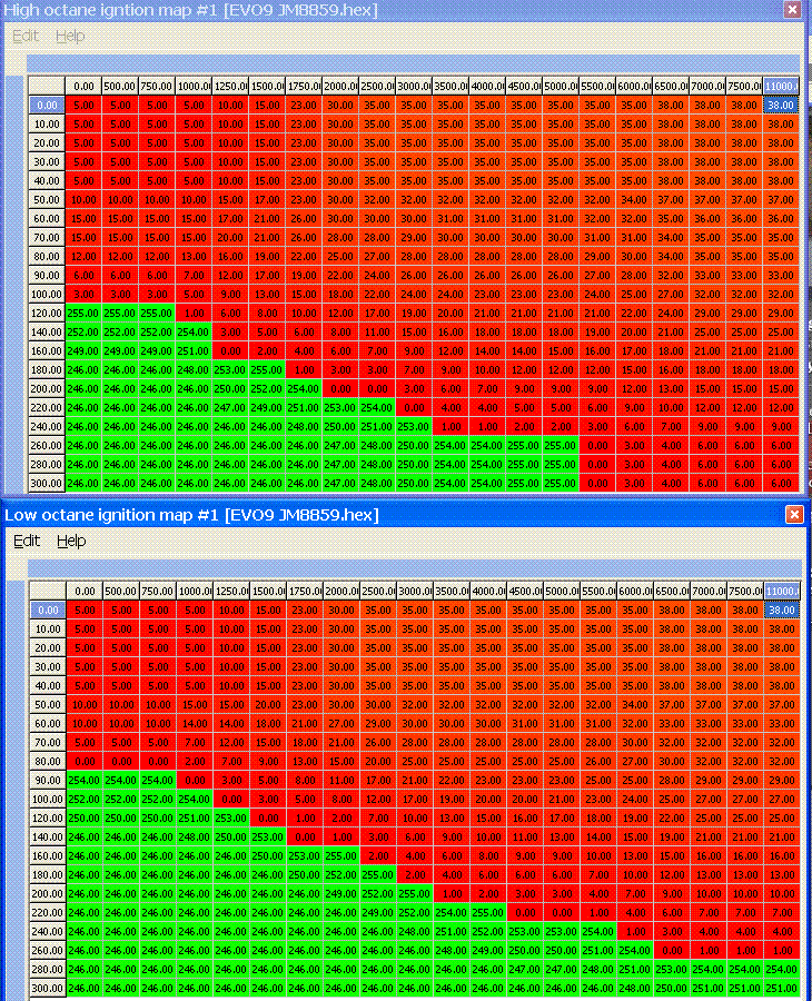

Postby S54fan » Thu Apr 13, 2006 12:35 pm
Fuel and ign#1 maps. I just manually entered the RPM values. I think the ignition values wrap around zero.
I think the load is % not g/s on these tables?
Ign RPM ends with 11000 RPM?
Evo9 fuel map
Postby GTODesign » Thu Apr 13, 2006 1:15 pm
The ignition values you see in the bottom left of your tables equate to -ve figures.
The load is g/s.
Bizzarely the RPM does end at 11,000. This also correlates with all Evo's back to E1.

Postby S54fan » Thu Apr 13, 2006 1:21 pm
Load as g/s is a bit odd as it will only use a few of the load zones at idle... surely it is g/cylinder charge or some multiplier thereof? 100% was suggested as estimate of 1 bar absolute - ie atmo pressure.
Postby jaytech » Thu Apr 13, 2006 8:28 pm
Fuel and Timing is Engine Load % not G/S....trust me on that one.
Those high numbers in the timing maps are negetive degrees of timing. And timing on evo 8 and 9 RPM is scaled to 11,000 RPM. So that is correct.
Also the Fuel and Timing maps are somewhat correct, but on the fuel maps, the upper right corner belongs on the lower left corner of the maps and vice versa. Same as for the timing maps.
And one other thing... Engine Load percent belongs on the upper row, and RPM is on left column of the map.
You did a great job there!!! :D

Postby S54fan » Fri Apr 14, 2006 12:09 am
Thanks Jason. So I've displayed it like a Power FC or hex editor but I've got the actual zones correct?
Postby jaytech » Fri Apr 14, 2006 12:18 pm
S54fan wrote:Thanks Jason. So I've displayed it like a Power FC or hex editor but I've got the actual zones correct?
Yeah, just easy to read the other way.

Postby GTODesign » Sun Apr 16, 2006 11:48 pm
jaytech wrote:Fuel and Timing is Engine Load % not G/S....trust me on that one.
Jason
Mitsubishi ECU Specialist
How did you come to the conclusion that engine load is % and not g/s?
GTODesign
Posts: 81
Postby jaytech » Mon Apr 17, 2006 12:49 pm
Jason
Because I have been doing Mitsu ECU's since 1992 till now, and they always go by Engine Load %(calculated engine load) and RPM on fuel and timing maps, on EVO, DSM, 3000GT etc. The MAF is calculated in g/s, and using in the MAF Scaling 2D table to convert it to calculated engine load %.
Example: 200% engine load is approximately 1 bar boost (2 bar Absolute)
Jason
jaytech
Posts: 22
Joined: Wed Sep 21, 2005 4:44 pm
Location: Arizona
Postby GTODesign » Mon Apr 17, 2006 1:17 pm
Ahh... I understand. I was (wrongly) assuming that the MAF g/s measurement was directly represented on the load scale. :oops:
