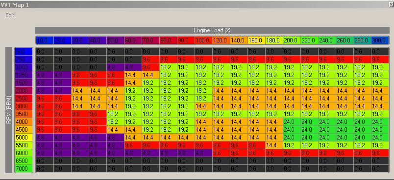

S54fan wrote:Anyone know what the scaling would be for the VVT map?
On JM8858-13 I know that for example the load 10 figures are 0, 0, 0, 4.8, 9.6, 9.6, 9.6, 9.6, 9.6, 9.6, 9.6, 4.8, 4.8, 4.8, 0, 0 from 500 to 7000 RPM. If I knew what these would be in hex I could search the ROM for this string?
Boost control details anyone?
On JM8859-15: Just check for the patterns on version 13 if the addresses are different.
VVT map address: 0x68BD size: 20x16
VVT load address: 0x7864 size: 20
VVT RPM address: 0x7896 size: 16
I have the boost tables for the EVO 8 ROMS still going thru the EVO 9 ROM, will get them hopefully by this weekend.

Postby S54fan » Fri Apr 21, 2006 12:26 pm
Thanks Jason. The tables from the Evo 8 would still be very interesting! :)

Postby S54fan » Mon Apr 24, 2006 1:53 am
I wondered if the first 10x9 maps was wastegate control from the shape.
Couldn't fathom any of the others from just looking at them.
MIVEC table

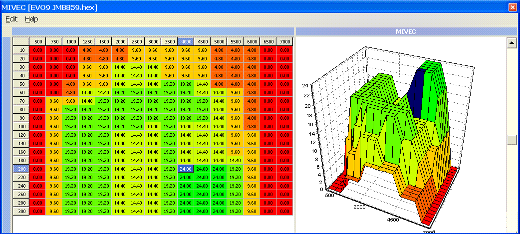

Postby S54fan » Mon Apr 24, 2006 3:06 am
I guessed at the scaling being in 4.8 degree steps. Axes are still the wrong way around with the version of ECU edit I'm using and I've put the load/RPM scaling in manually again.

Postby jaytech » Mon Apr 24, 2006 6:39 am
Here is how the MIVEC map looks like...

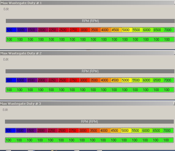

Wastegate Max duty maps
Postby jaytech » Mon Apr 24, 2006 6:50 am
Here are the wastegate max duty info found thru disassembly:
Wastegate Max Duty #1: 3F38 16x1
Wastegate Max Duty #2: 3F4E 16x1
Wastegate Max Duty #3: 3F6A 16x1

WG Duty
Postby S54fan » Mon Apr 24, 2006 7:16 am
Since they are maximums I would assume it wouldn't run 100% at least in the early midrange to avoid overboost. Presumably it runs closed loop control. Does the US model have a MAP sensor like the JDM and UK models?
Re: WG Duty
Postby jaytech » Mon Apr 24, 2006 7:28 am
S54fan wrote:Since they are maximums I would assume it wouldn't run 100% at least in the early midrange to avoid overboost. Presumably it runs closed loop control. Does the US model have a MAP sensor like the JDM and UK models?
It runs at 100%, it uses the boost offset value, and boost load % tables and boost error table to determine actual duty cycle. The MAP sensor is only used for EGR Flow determination on all models.
jaytech
Posts: 22
Joined: Wed Sep 21, 2005 4:44 pm
Location: Arizona
Postby S54fan » Mon Apr 24, 2006 7:36 am
Sounds quite similar to the Subaru then?

<map name="68BD -> VVT (Variable Valve Timing) Map" type="3" active="1" help="" >
<cols count="20" format="%.f" func_2val="[value]/32*10" func_val2="[value]/10*32" offset="#7A64" power="2" caption="Engine Load (%)" desc="Engine Load (%)" signed="False" reverse_bytes="True" />
<rows count="16" format="%.f" func_2val="[value]/128*500" func_val2="[value]/500*128" offset="#7A96" power="2" caption="Engine Speed (RPM)" desc="Engine Speed (RPM)" signed="False" reverse_bytes="True" />
<data order="RC" format="%.2f" func_2val="[value]" func_val2="[value]" offset="#68BD" power="1" caption="VVT Angle (Degree)" desc="VVT Angle (Degree)" signed="False" reverse_bytes="False" color_dir="0" inc="20" incb="170" inc_dir="1" />
</map>
