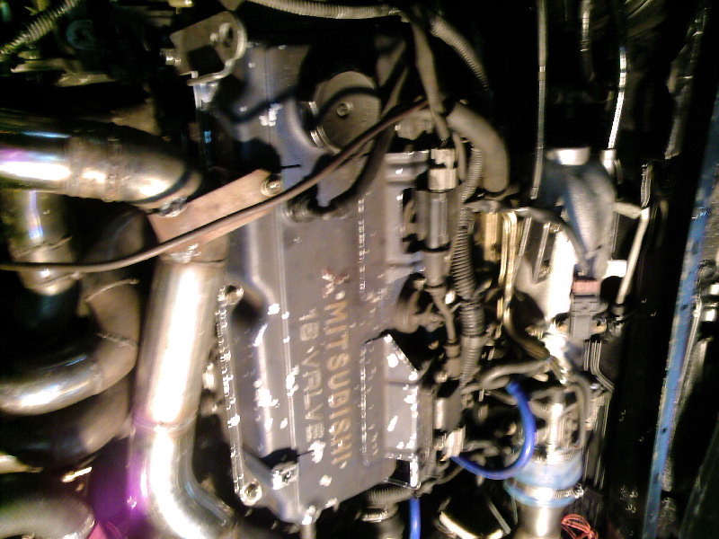

Postby Zakie@TIC » Sat Aug 16, 2008 7:00 am
One more
