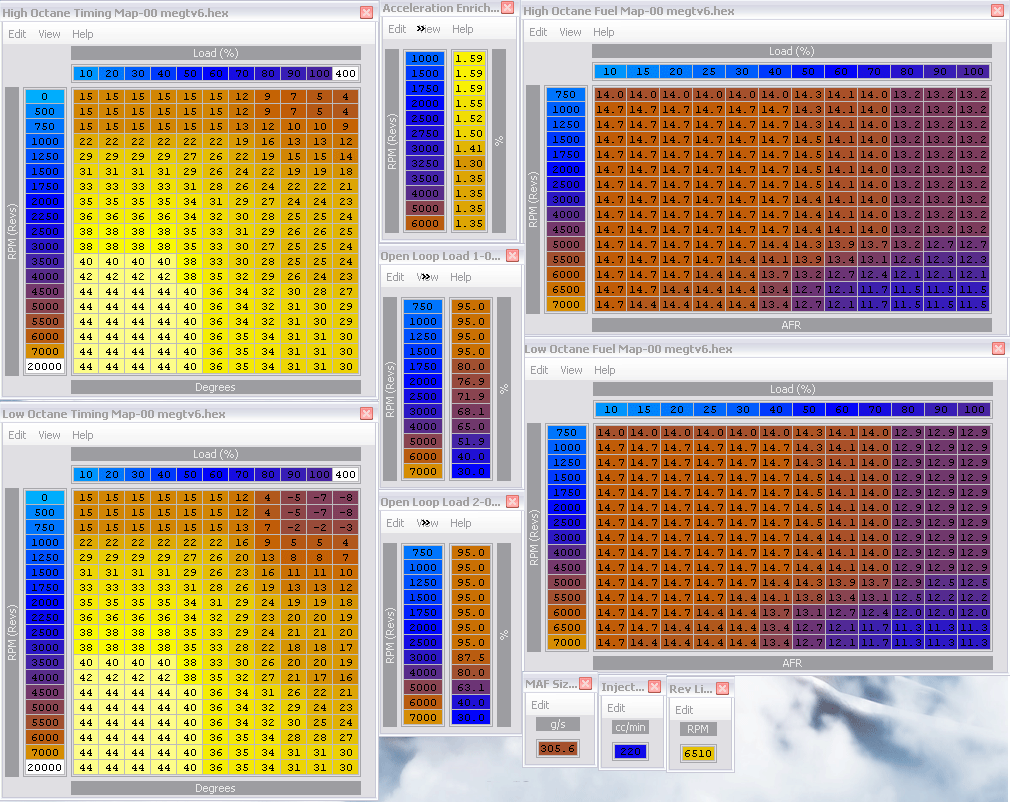

Postby Travis » Fri Jan 04, 2008 12:34 am
Never mind, I lied. Oops. Now that I look at my graphs again I see both fuel maps go to 100% at 5 and 10% increments and both timing maps go to 400% load at 10% increments. My bad.
I've attached the screenshot.
2000 Mitsubishi Eclipse GT - Stock Maps Screenshot
Travis
Joined: Mon Sep 04, 2006 2:09 pm
Location: Albuquerque
Postby repforenzo » Fri Jan 04, 2008 1:12 am
Yeah, same as mine...
