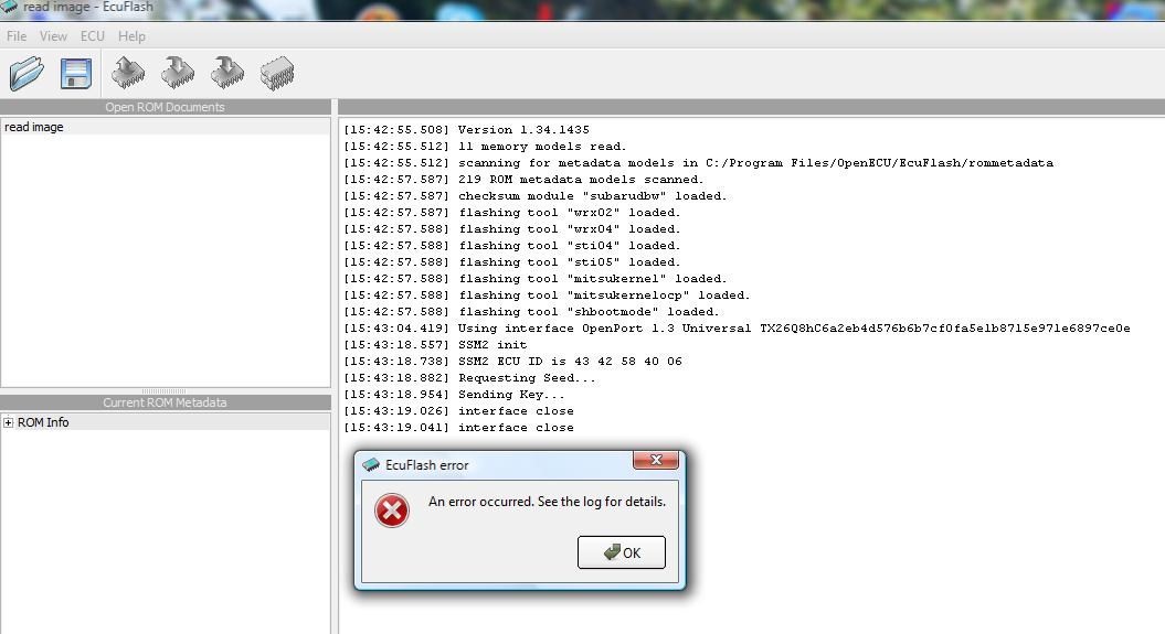

I can not get a readout from this model.
Does anyone have a solution?
HEre is a screenshot:

Postby mitsubo » Sun Dec 23, 2007 5:47 pm
Are the green connectors connected, is car in test mode?

Postby mrcsport » Mon Dec 24, 2007 7:30 am
yes, green connectors is connected

Postby mitsubo » Tue Dec 25, 2007 4:03 am
Is your car with electronic throttle? (Drive by wires)

Postby mrcsport » Thu Dec 27, 2007 4:27 am
car is with electronic throttle

Postby mitsubo » Thu Dec 27, 2007 4:34 am
You should look for another green connectors which are situated under a plastic cover by the pasanger's right foot

Postby mrcsport » Thu Dec 27, 2007 9:26 am
there are only 2 white connectors under the passangers feet that I found.

Postby mitsubo » Thu Dec 27, 2007 11:48 am
Hmmm...when you first found green connectors, were they connected or not, when you connect green connectors do the fans blow when you turn on the ignition?
Was your car flashed with ECUTec before?

Postby mrcsport » Fri Dec 28, 2007 2:52 am
It is my cousins car, he is not the first owner, so we do not know if it was ECUtec flashed. How can I tell? Is there a way to know? I have read here that they mess it up or lock it somehow. Is there a way to read it if it is ECUtek flashed? Anyhow, yes, I get the fans blowing, and when I found the connectors, they were not connected. Thanks for the answer dude, your'e wery helpful

Postby mitsubo » Fri Dec 28, 2007 5:53 am
You did everything correct. I think your car was flashed with ecutek, because i succesfully flashed 2 or 3 EDM STi and didn't have any problems.
There is no way to unlock the ecu (yet), now the only solution is to buy a used ecu and to flash it :D

Postby letsteyr » Sat Feb 02, 2008 12:17 am
your ID is one of WRX but not STI !!!
4342584006 = A8DH200Y which is a WRX !!
Only the green connector has to be plugged. Should work very well
