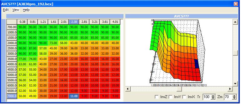

<map name="AVCS???" type="3" active="1">
         <rows count="14" func_2val="[value]*50" func_val2="[value]" offset="#2BAAB" power="2" format="%6.2f" caption="RPM" desc=""/>
         <cols count="10" func_2val="[value]/8192" func_val2="[value]" offset="#2BAC7" power="2" format="%6.2f" caption="Engine Load" desc=""/>
         <data func_2val="[value]" func_val2="[value]" offset="#2BADE" power="1" format="%6.2f" caption="" desc="" color_dir="1" inc="1" incb="5" inc_dir="1"/>
      </map>
You said this ecu came out of a 2005 WRX? What would this map be? Seems to me that its most likely AVCS map. would a 2005 Pro*rive ecu have AVCS??[/code]

Postby Spiider » Sun Feb 26, 2006 6:35 am
I don't think thats AVCS. My AVCS map looks very different.

Postby Freon » Tue Aug 08, 2006 10:16 am
That isn't an AVCS map. Here are some example AVCS maps:
