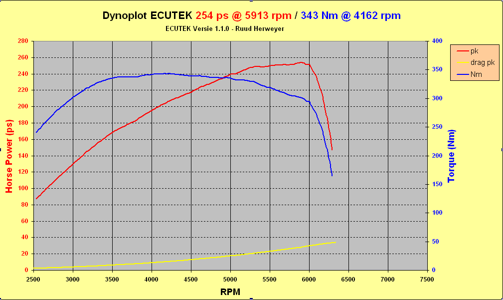

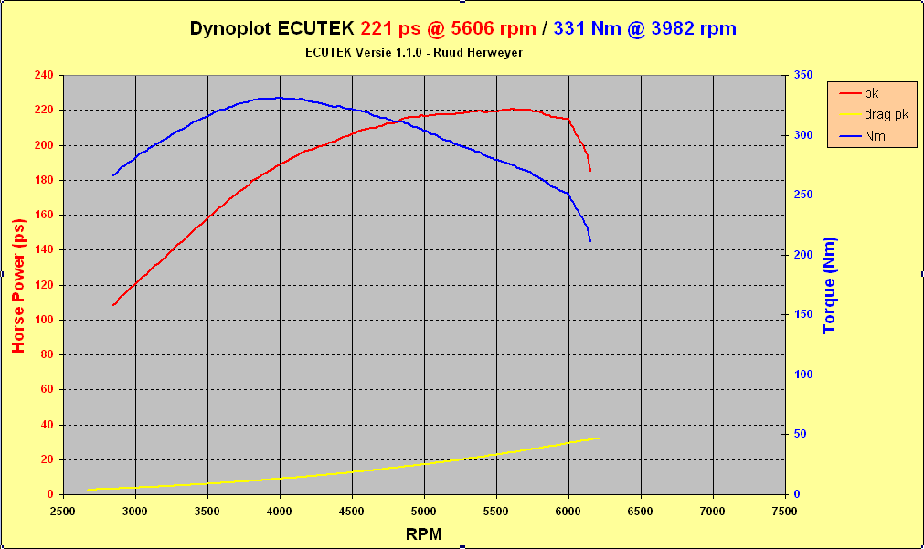

Postby west_minist » Fri Jun 09, 2006 10:09 pm
I like this Dutch program.
It shows you a kind of a Land base Flywheel (verifying this) Dyno base on the EcuTek Dyno info.
Tell me what you think :)
PK is PS. I could not get it to show the USDM dyno info, but JDM is good :)
So in USDM format @ the Flywheel, 251hp@5913rpm / 253lb.ft@4162rpm
Boost < 15psi
218hp@5913rpm / 244lb/ft@4162rpm
251hp@5606rpm / 253lb/ft@3982rpm
stock_dyno ramp.png (25.03 KiB) Viewed 8036 times

Postby JRSCCivic98 » Sat Jun 10, 2006 10:31 am
west_minist wrote:So in USDM format @ the wheels, 250.52hp@5913rpm / 252.95lb.ft@4162rpm
Wait, so you're saying that this car is making that much at the wheels? Hate to tell you, but there's no way that's possible. Even with a Stage 2 WRX. Not only that, but I tend to trust the DeltaDash Road Dyno numbers more... when I compared those to a Dynojet Dyno the numbers were right on or slightly lower on the DD software.
Postby west_minist » Sat Jun 10, 2006 10:37 am
Thanks for the correction.
The statement above stated flywheel.
Postby JRSCCivic98 » Sat Jun 10, 2006 6:01 pm
Ahh, cool then... yeah, first you said flywheel, then you had "at the wheels" at the bottom. I was like WTF? That's more in line with your hp figures from DD.
Postby west_minist » Sat Jun 10, 2006 6:04 pm
We might know the diff., but other would not and we need to be correct.
Thanks to catching that out.
