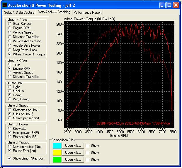

Postby Spiider » Sun Apr 16, 2006 2:06 pm
Here is the next rev of my map.
This one uses the s202 ignition map, ignition correction map, and has the hole fixed from 2000-3000rpm in the vvt angle settings.
Output ncreased ~10hp, and ~20ftlbs, and the peaks moved lower in the rpm range considerably.
Dyno Test: jeff rev 2
Maximum Wheel Power: 263.2 BHP @ 5742 RPM
Maximum Wheel Torque: 262.9 LbFt @ 4964 RPM
Power to weight ratio: 169.8 BHP per ton
DeltaLog-ah581-5122-Sun Apr 16 2006 17-31.53.zip
(1.89 KiB) Downloaded 327 times
ah581 rev2.JPG (87.93 KiB) Viewed 8774 times

Postby west_minist » Sun Apr 16, 2006 3:31 pm
How do the car feel in that spot now?
It looks like your stock map had better low end power. Even the low load ign maps seems a tab higher than the s202 - if my maps are correct.
Do you feel a difference in the low end?
Postby Spiider » Sun Apr 16, 2006 3:53 pm
They are so close at the bottom end, I can't really feel the difference.
Actually the entire exercise has been surprising in that regard, so much changed in the maps and so little change in performance overall.
Maybe I'll have to let some learning occur to see if it gets better.

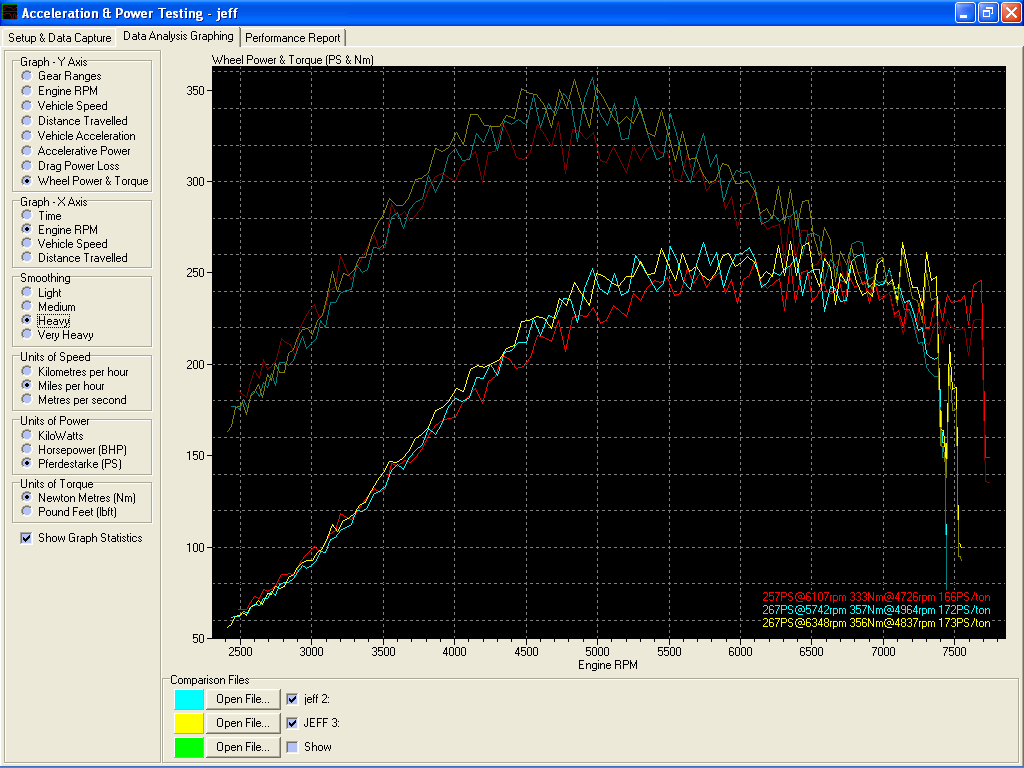

JDM STI Dyno map tuning jap.png (42.71 KiB) Viewed 8731 times
JDM STI Dyno map tuning.png (52.71 KiB) Viewed 8732 times

Postby west_minist » Fri Apr 28, 2006 5:10 am
Jeff - Stock
Jeff2 - New ignition map (S202)
Jeff3 - Ign map clean up w/ AVCS tuning and clean up in the usual 1800-2500rpm hole

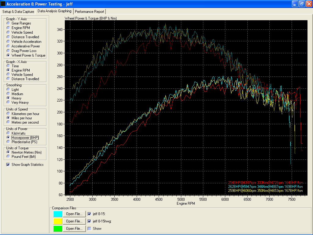

Postby west_minist » Sun May 14, 2006 7:19 am
Hello Everyone!
The tune is coming along slowly, since Spiider have been very very busy lately.
Here is a dyno from last week, down in 4gear. 3 gear is too fast and does not spool the turbo enough.
Jeff = 3 gear run - stock
Jeff 8-15 = 4gear runs - tune
Jeff 8-15-hwg = 4gear run - high wg control
Dyno - stock comparison - 5.png (48.34 KiB) Viewed 7598 times
Postby calvinc » Sun May 14, 2006 11:47 pm
use the Per Gear Wastegate Duty Compensation map to curb that. use it to get near full boost in 1st and 2nd too. try not to play with boost maps if they are fine in 4th,5th and 6th.
