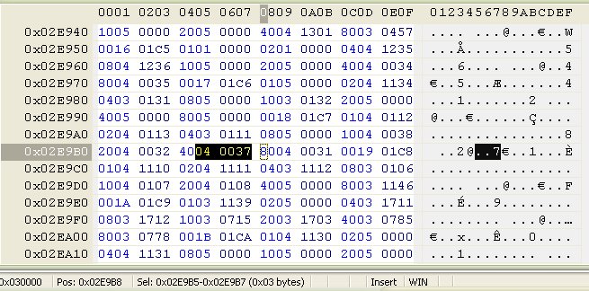

You don't have to worry about getting everything lined up in the hex editor. It is pretty obvious where the cel codes. Below is the screenshot of the p0037 code. You just need to replace the 0x040037 with 0x050000. You can see some other codes like p0031, p0032 and some codes that Subaru disabled with 0x050000.

You do not change ALL the 0x0037, just the one listed above. The cel codes are all in the same area and are always near the end of the rom (16bit). If you change all instances of the 0x0037 then you are changing programming logic and other data that has nothing to do with cel codes which is probably why your car ran funny. Supposedly, the 03/04 preceding the cel codes indicates whether it is a Subaru specific or OBDII generic code but I haven't found that to be the case as the JDM seem to reverse these codes on certain cels.
Change the 0x040037 shown in the screenshot above to 0x050000 in that particular location and only that location.
