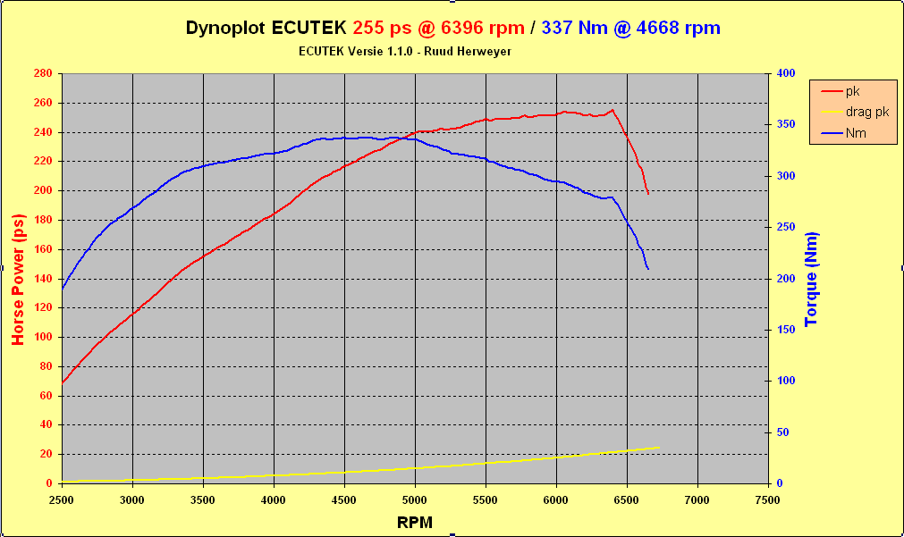

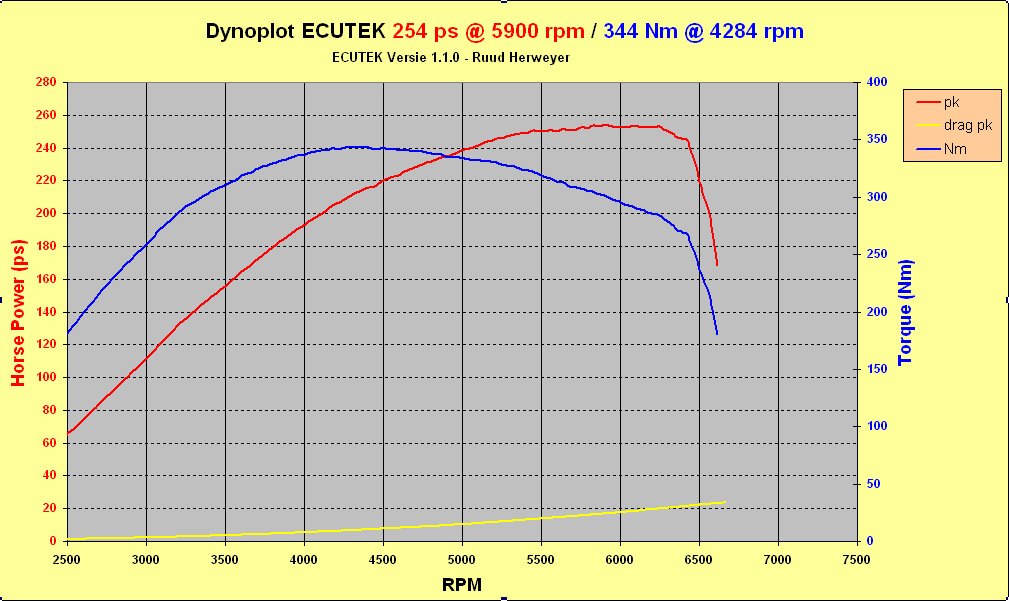

Max boost ~ 13.6psi in 2nd gear
250hp@5900rpm / 254lb/ft@4284rpm
v1 Dyno.png (27.35 KiB) Viewed 7598 times

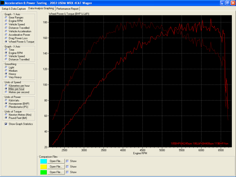

184.6 BHP @ 6245 RPM / 185.6 LbFt @ 4408 RPM
v1 w-Dyno-lores.png (89.01 KiB) Viewed 7641 times

Since the boost is not going over 15psi, I have set the boost maps and future wg maps for that boost in v1-1, just in case the boost problem is fix in unless wg controls

Postby west_minist » Sun Jun 11, 2006 9:26 am
The Flywheel graph above is wrong.
Tranny loss was the same as an manual.
Subaru 4EAT drive train losses range from 30-35%, so some sites state.
Monday 12th re-edit:
I have found some info that the losses could be 30%, which is comparable to stock models between a Manual and auto.
So I have reposted the graph above w/ 30% loss.

Something I want to point out. DD Road Dyno has gear ratio calculations that it takes into affect to properly calculate the power of a car. The gear ratios of a manual are not the same as the automatic. You'll need to find the gear ratios (if even available) of the auto and put them into the custom gear ratios values... otherwise you're numbers will be off all the time.
Postby west_minist » Mon Jun 12, 2006 9:00 am
That has been done.
I have an auto too.
So far, the auto's I found on the usa sites have the ratios and matches up with this auto.

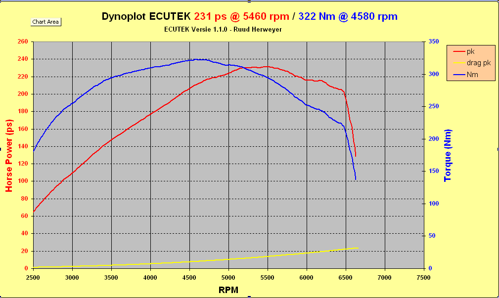

Cobb Stg1
Cobb Stg2 Dyno.png (26.89 KiB) Viewed 7558 times

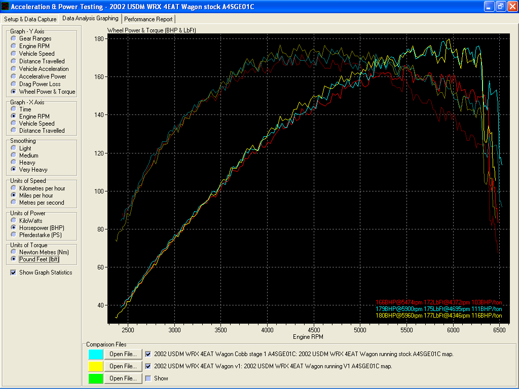

Wheel comparisons
Comparion of stock, Cobb stg1 and v1 power stats
2002 USDM WRX 4EAT Dyno history01u.png (47.11 KiB) Viewed 7535 times
