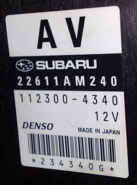

i opened up the ecu and found the following:
on case.......AV22611AM240 (DENSO)
on chip........64F7058F80 BX0419 BD12471
i got the car in Mar 07 but it was manufactured in 2006 so I'm hoping i have an ECU that can be flashed ie. not have to wait for a new type CAN cable.

Postby radsdau » Tue Mar 25, 2008 2:53 pm
Based on what I've seen, you have a very good chance that this will be usable with ECUFlash. No guarantee though. You should be able to read the SSM ID with ECUFlash, regardless.
What's the text on the PCB? It'll be something like "112331-___" etc.

Thanks so much for the quick reply.......the text is.......
112331-1490

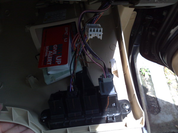

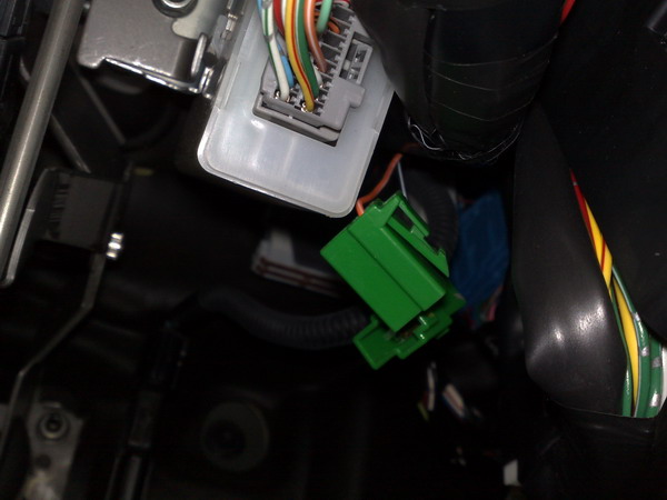

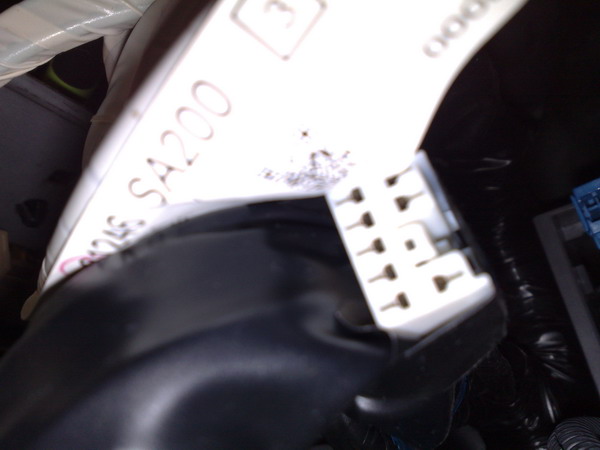

Postby hairaida » Tue Mar 25, 2008 11:19 pm
ok.....please see pics attached.......aside from the green connector, there is a white one near it that's not connected. And there's another white connector near the fuse box that's tied up and also not connected. Do I have to connect the white ones?? or short certain pins? they both look female so I'm... :? :?

Postby radsdau » Wed Mar 26, 2008 5:39 pm
I'm sorry but I don't know about the extra white connectors. I have seen this type of car before and have also not been able to communicate with it. I assume Subaru have changed their hookup method. I don't know if CAN is involved in this now. If so, the current OpenPort cables will not work with these cars.
